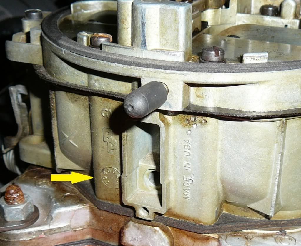

                    If it's a replacement could the date be the 347th day of 1977?
                    Can you post a picture of the numbers stamped in the circle on the back of the carb or include them in a post?
                    Here's a link to questions I had about my carb. https://www.forums.ncrs.org/showthre...+carb&uid=4652

                      The date code of "1089" would not be correct for my car which was assembled on or near 10/4/68. I don't have a picture of the carb at the angle shown in your picture.

                        Hi Floyd
                        Here is a pic of a 215 carb and the date is stamped on the corner of the base plate. Late 68 or early 69 carbs has the stamping on the Base.
                        This carb is dated Sept 5th. Pretty darn close to your 10/4/68 assembled car.
                        Hope this helps.
                        Grant

                          It does. This would be more typical according to the TIM&JG. Thanx.
                          In fact, it would be perfect for my car. Is it for sale?
