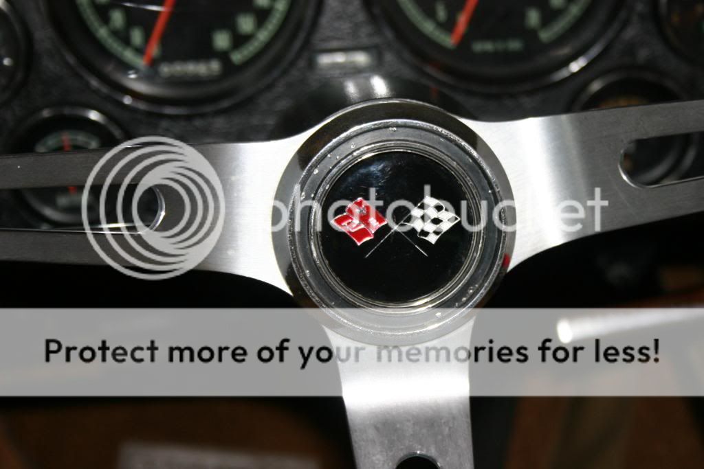

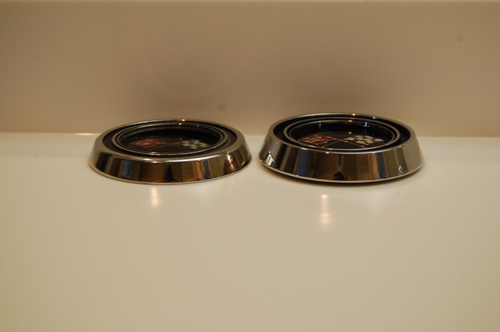

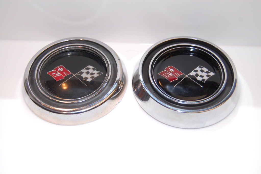

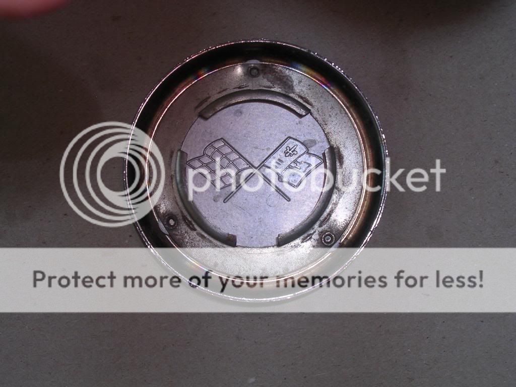

    I thought you all would like to see the difference between my original horn button and the reproduction i purchased.
    My original button had been taken apart by the original owner and i had to get creative to put it back together. Im not sure why he took it apart since the original emblem is in good shape. The retaining clip was missing, so i removed the one that was installed on the reproduction horn button. However, then i came to the delima of how to attach it to the original since the rivets had been drilled out. Solution, 3m panel bonding adhesive. I put c clips to hold the pieces in place while the epoxy dried. I have yet to find an product that is stronger than the 3m panel bonding adhesive. It is truly impressive.
    Horn works like a champ now. It's a little pitted and weathered, but i like it better than the repro.
    Oh and in case you are curious of the build date for my car due to the white corner in the flag, it is 4-18-66

    Wow, big difference in thickness. Is there a difference between telescoping and non-tele columns as to which horn button was put on? Don't know. Maybe that explains the difference in thickness?

      Tele uses a totally different horn cap.
        Re: 1966 Original Horn Button vs. Reproduction
        The one on the left appears to be a '67 horn button.

          I suppose anything is possible and i see what you are saying now that i look at a few parts catalogs. I assumed that the button was thicker due to being a reproduction.
          However, the emblem was firmly stuck below the cast in rivets and did not appear to have ever been removed. I think that the checkered flag with the white square in the left upper corner was only used in 66. Feel free to correct me if i am incorrect.
          So, did they switch to a thinner design in the middle of 66, or is it confirmed that only the 67 horn button was a thinner design?

                  Rounded edge button was one of the "safety" requirements starting in '67. 65- 66 were the thicker design without the rounded outer edge.
