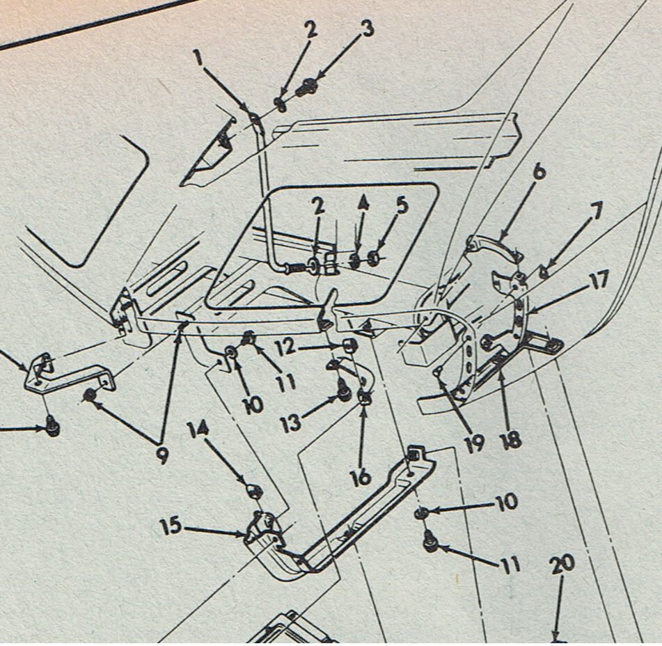

                        Drawing from parts book. The shape seems to have a bend at the bottom, but the threaded style is correct.

                          Wayne-----
                          I think this is a drawing of a 1973. The 1974 set-up is completely different and uses the 342235 rod which is straight. Two rods are used for 1974.

                            Looking at the exploded view it shows the nut and a washer. This has a washer captive to the nut. Please see below.

                              Thanks Joe, The old book I have shows that pic, for both 73-74.
                              If the 74 is straight, I would say we probably have it.
