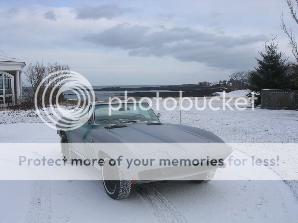

                            Hi Don, here are the first pictures of my car , with windshield in, interior done and yes, a new wheel. After 42 years, it was time for a change. My son is 6'6" and will get the car some day. He does not fit with old wheel. Also , I have power steering and the new wheel feels great. Looks funny, but to a non beleiver, they would not know the difference. When I visit the NCRS bunch, I will bring the old one with me, for a quick switch, NCRS guys can be a tough bunch, so I am told.
                            Two years ago
                            Today plus 30,000 miles over the last year

                              Looks fresh as a daisy Jack !
                              None the worse for wear after a 30,000 mile year. Yikes!
                              I just logged 800 in mine last weekend, and thought of your 500 mile days a couple of times as I dragged my 60 year old bones out of the driver's seat... I am still not quite sure how you did that for a solid month. You are an inspiration.

                                3 months Don, 3 months, and thank god for the forum members who kept me alive and helped my insane quest in an old car with an old body. But , I looked good.......felt terrible......but looked good,,,,,, most people never saw me try to get out of the car at the end of the day...........
                                Just like a car wash makes you think the car runs better
                                The seats, and interior fresh up , a motor that just hummms,
                                feels like it did more than 40 some years ago.
                                I guess I would lose a few points for the wheel and two tone interior..........
                                Tough bunch
                                Jack
