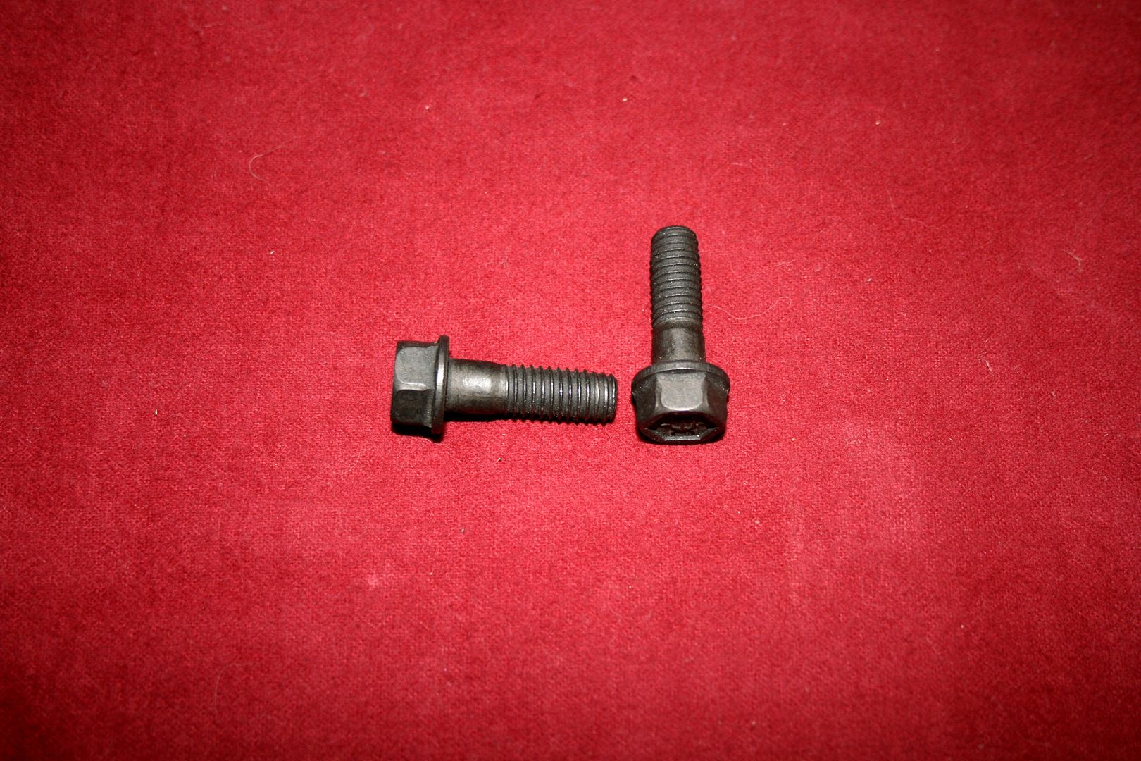

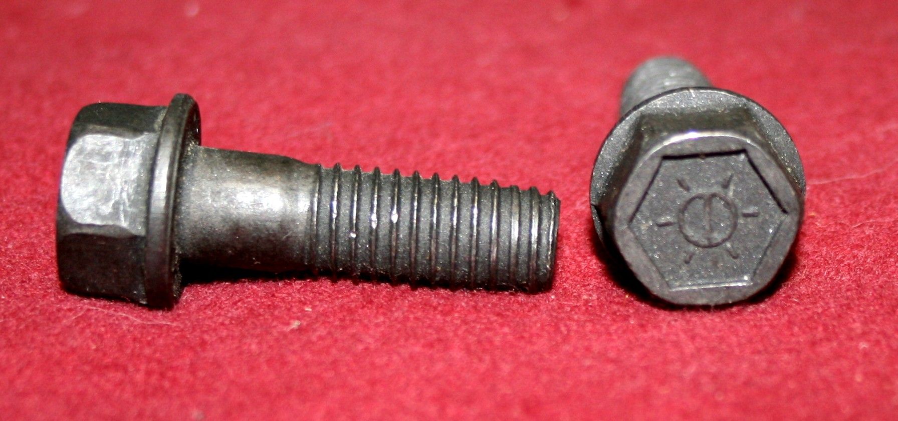

    If nobody posts a pic before I get home tonight, I'll post one of the entire bolt.
    It's a very funky bolt. The kind you don't take home to...
    Kramden
    • Mark D.
      • June 30, 1988
      • 2151
      Re: 72 454 exhaust french locks
      Told ya I'd do it before this day was out...
      Kramden

                          I had a 40k mile original car - no french locks.
                          I was the first to remove the exhaust manifolds - for the restoration.
                          special bolts on the outer ends, they are self locking I hear...
                            • 43221
                            #28
                            Bill-----
                            When one runs the bolts out and in, it will be very obvious that they're not a regular bolt. They go in and out very hard.
