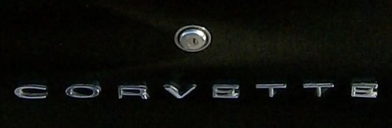

    Terry, here we go!
    I am the original owner, which means I am old and forgetfull. That said, I best remember my lock mounted flush to the panel with no bezel.
    Forty years ago there were other things on my mind
    I had the car painted and questioned my judgement when I looked at the AIM and a friends car, also a '71. He is the original owner and has the bezel on his alarm lock.
    To bezel or not to bezel, now that is the question? The AIM does show it so what do I do?
    Ken

          Ken, mine was not built long after yours in '72, while the "painter" didn't instal mine either, still no bezel to be found. I think I have before pics if you need me to look.

            My 70 #12981 June 16 with the escutcheon. Mine was filled in by the original owner proir to 73. I found out when the alarm horn went off one day after going over a bump. Found the switch in a box of parts and when I looked at the filled hole from the inner side, I could see the circular hole with the notch perfectly since the patch was light compared to the dark fiberglass. I think if you check from that view as I did you'll know if the escutcheon was there originally.
