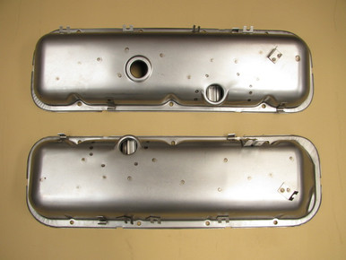

                        I believe you all but the attached picture confuses me. CPH is a 1972 broadcast code and the sticker looks authentic but the covers have spot welded wire looms on them. Any idea where these came from? thanks!!

                            The driver side and passenger side have the loom spot welded to the cover.
                            on 72 only there is a loom spot welded to the top center/rear of the DVR side, just for one wire to attach to (#7).
                            the covers in your attachment are for 1971 and maybe late production 1970. There may be other uses, not sure. The two looms that are top, mid center are not correct for 1972 (99% sure).

                              The "CPH" suffix code was used for both 1971 and 1972. However, the fact that the codes were the same for both years does not mean that the engine assemblies were identical. The engine codes and associated engine build configuration are specific to model years. So, a "CPH" engine configuration for 1971 is not necessarily the same for 1972.
