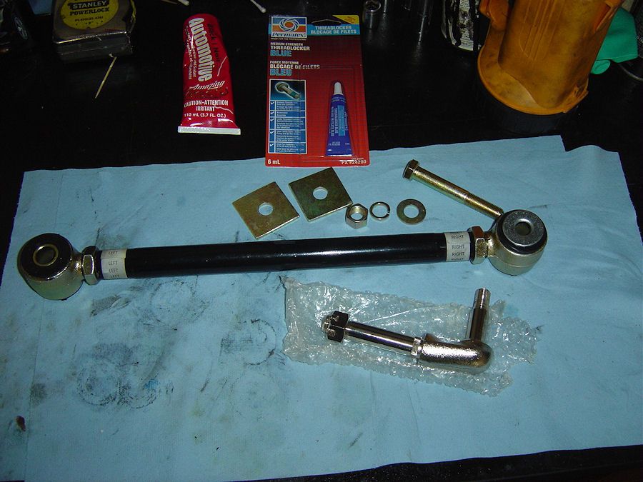

                              Lots of interesting info in this thread. I am going to give the poly adjustable rear struts a try on my 1974 as I already have purchased them. They seem sturdy/robust with forged ends. I shall retain the OEM struts and if the poly units do not work out I will re-bush them and re-install. But for my Sunday afternoon boulevard cruising style of driving things should be fine. I can only hope those shock mounts will move for me....I have the VBP "pound" tool and a heavy hammer but if need be a friend has an air hammer and a torch.

                                Job is done. The 1974 strut rods do not have outer sleeves. Bit of a mess after 97,000 miles but perhaps a (+) comment on the durability of GM original engineering.
                                Not NCRS but new VBP composite spring (with heat shields/SS holding straps) and adjustable strut rods with poly bushings make a world of difference in my 1974. Those are snugged down very well with blue Loc-Tite and wrench muscle. No squeaks and very nice handling. The old 9-leaf steel spring was just....finished. It has been recycled at a metal processing facility. I saw no need to preserve it. If you are into that, Eaton can help you.
                                It sits a bit high but I have lots of room for adjustment on the 8" spring bolts. Tires are 235-60 so that has to be taken into account.
