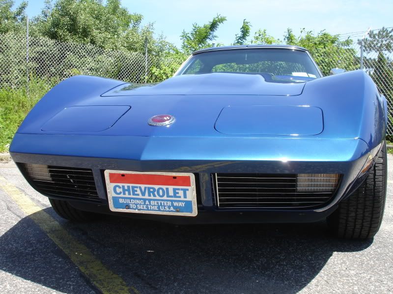

                        We'll I have collected all the materials to fabricate this rubber air dam extension. Rubber, metal strips, metal primer paint, semi gloss black paint and rivets.
                        The only thing that was NOT mentioned here was how much rubber in width that I will need to cut a V-Shape just under 4" rubber flap? I got a 1/8 thickness 12" wide by 51" long.
                        I think that will work. I just soaked my plastic air dam bolts with lubricate to help the bolts come out easier.
                        I intend to place the plastic air dam on the rubber or template (in the middle) and go both sides from the center line just under 2"?
                        Does this sound right? Mathematics and Alegbra was never my strong point in school! Maybe I should have studied harder?
                        Thanks everyone.
                        If and when this part is finished..maybe I could start another patent and sell to Doc Rebuild. I am sure that I am not the only one with RPO's LS4 and C60 that would like to have this piece.
                        Peter Gregory # 4157
                        National Corvette Restorers Society Since 1980

                          My rubber air dam is .200 thick, 3 5/8 tall. If you put it down flat, it is about 10 1/2 inchs from the bottom of the V to the top of the ends. Hope that helps.

                                Ok everyone I am done with this. It is complete thanks to my co-fabricator John Marisco of the NCRS Rocky Mountain Chapter and ALL the researchers that posted here to help us get this done. A big THANK YOU!
                                It took most of the day on Thursday and sometimes you can over calculate the numbers so at the end I just made a drawing on a template and then we measured it to make sure it was what it was supposed to be.
                                It took almost two hours to get the air dam back on as some of the flat washers were hitting the metal braces (and my shoulder and back) didn't speed things up when getting up and down.
                                Here is a pic of the completed rubber air dam with rivets.
