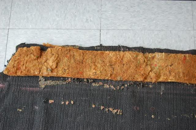

                  Hi,
                  I'm a 71 person but interested in the original style and color underlayment too. The reproduction carpet I see has the blue/gray 'jute' that's been described.
                  Here are 2 pictures from my 71.
                  The first is the underside of the wheel house carpet and underlayment. It has the rubber side against the carpet. Note the color and 'tight' texture of the jute.
                  The second picture is the carpet for the bulkhead behind the seat. The underlayment is a different color, has no rubber layer, and appears to be quite a looser material than the wheel well pad. In 71 this material (or one very similar to it was used as a heat/sound barrier on the transmission tunnel too.
                  Are these the color(s) that's seen in 67?
                  I'd be interested in the proper material in either of the versions, so will watch your replies about it's availability.

                    Alan,
                    Your first picture looks just like the '67 underlayment I removed, "tight texture", with individual red and blue (and green?) threads woven throughout.

                      Guys,
                      Maybe there was a running change during the 67 poduction and that is why the jute may have had more than one color. As for the early 70's, one oF fmy own cars which I still ahve the original carper/jute is just like Alan's photos.
