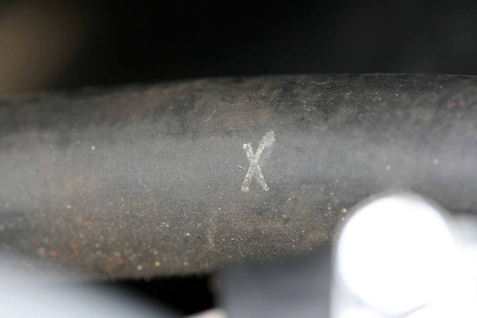

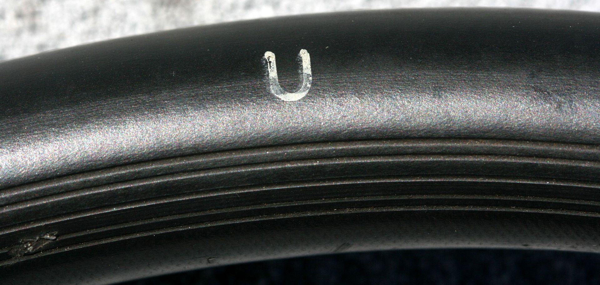

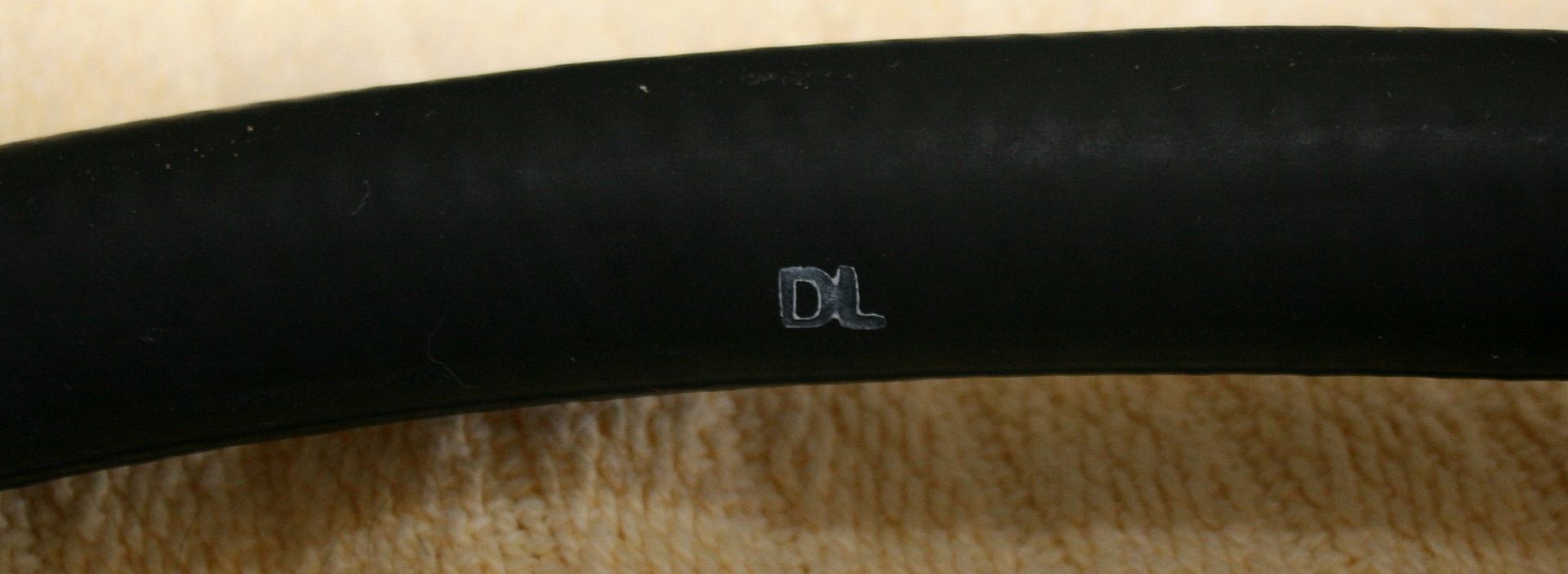

            Here are some examples of heater hose markings from 68 thru 72. As my friend states, it's going to require some research to determine what they mean, specifically.
            This one from Terry's heater hose...
            And another from a 69 SB...
            This is a repop stamp I put on my 69 L89. I have no idea if it is right or wrong...

              BTW: First image is from a 1970 LT1. And I think there IS a difference between grooves and raised ribs, and it has nothing to do with your point of view. I have impaired depth perception and I can tell the difference.
