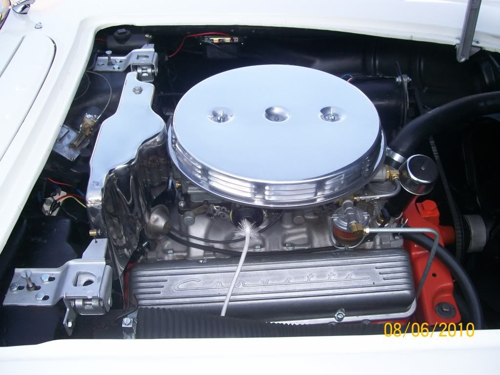

            Here are a few pics of the car, FYI:
            I'll try to find out more and pass it along, as I discover it.
            Thanks again for your time and help.
