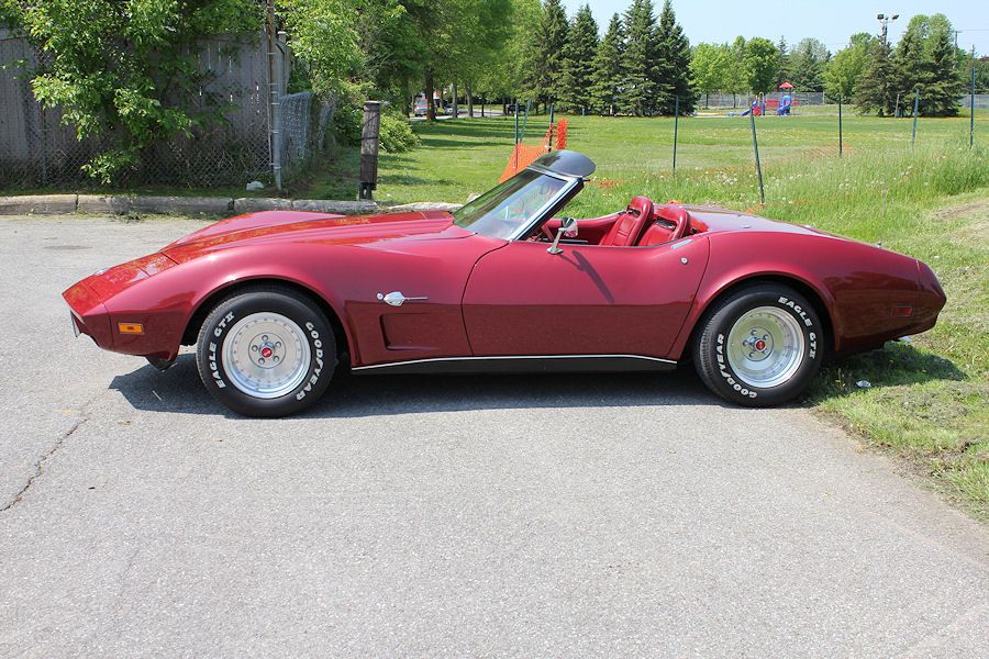

              I had to replace the fuel pump on my 1974 with A/C a couple of days ago owing to a faulty diaphragm (you will find this job described in the dictionary under cruel and unusual punishment). Today I managed a 30-mile test run including highway speeds. Everything is A-OK!
              The engine is an L-48 and I too have the TH400. At 70mph the tach was reading 2,800rpm. The L-82 may have different gearing to account for your 3,500rpm but it does seem a little high. Perhaps someone with a C3 L-82 automatic can make a more informed comment.
              *Edit* - Ambient temp is 75*F and the car runs at 180*F. As per Mike's comment I do have the chin spoiler and appropriate rad seals. I did NOT have the A/C on.
