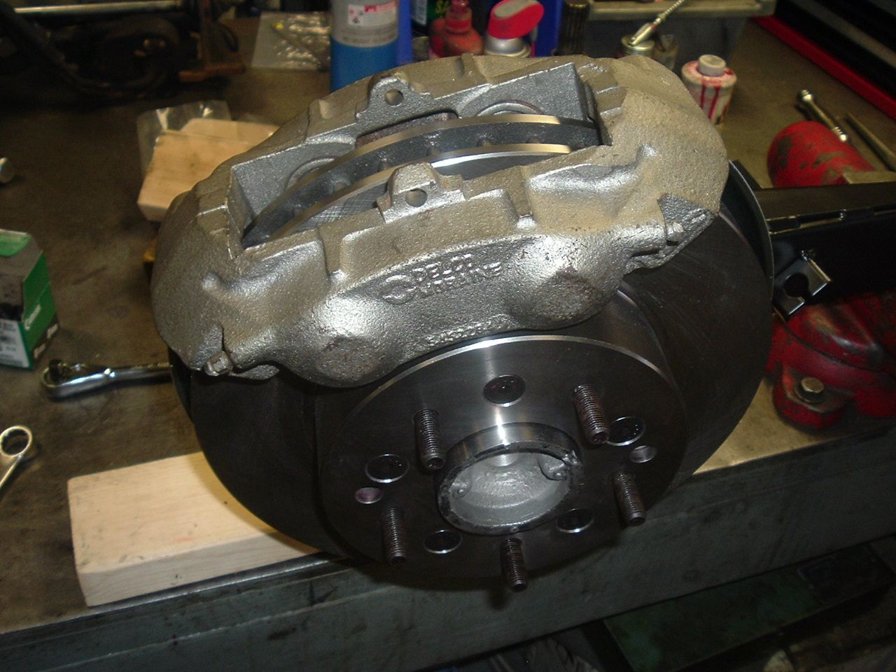

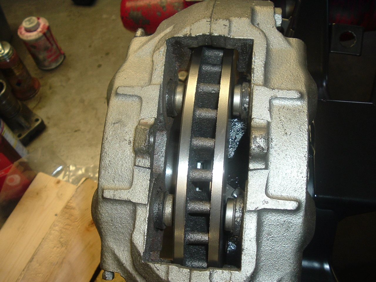

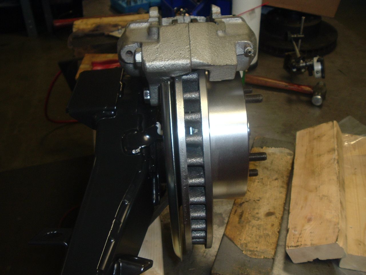

          I hope others don't mind I post pictures, but this may help you. This is what I'm talking about. This is a '66 arm with new rotor but original bracket. You can see the caliper is centered on the rotor. Does yours look like this?

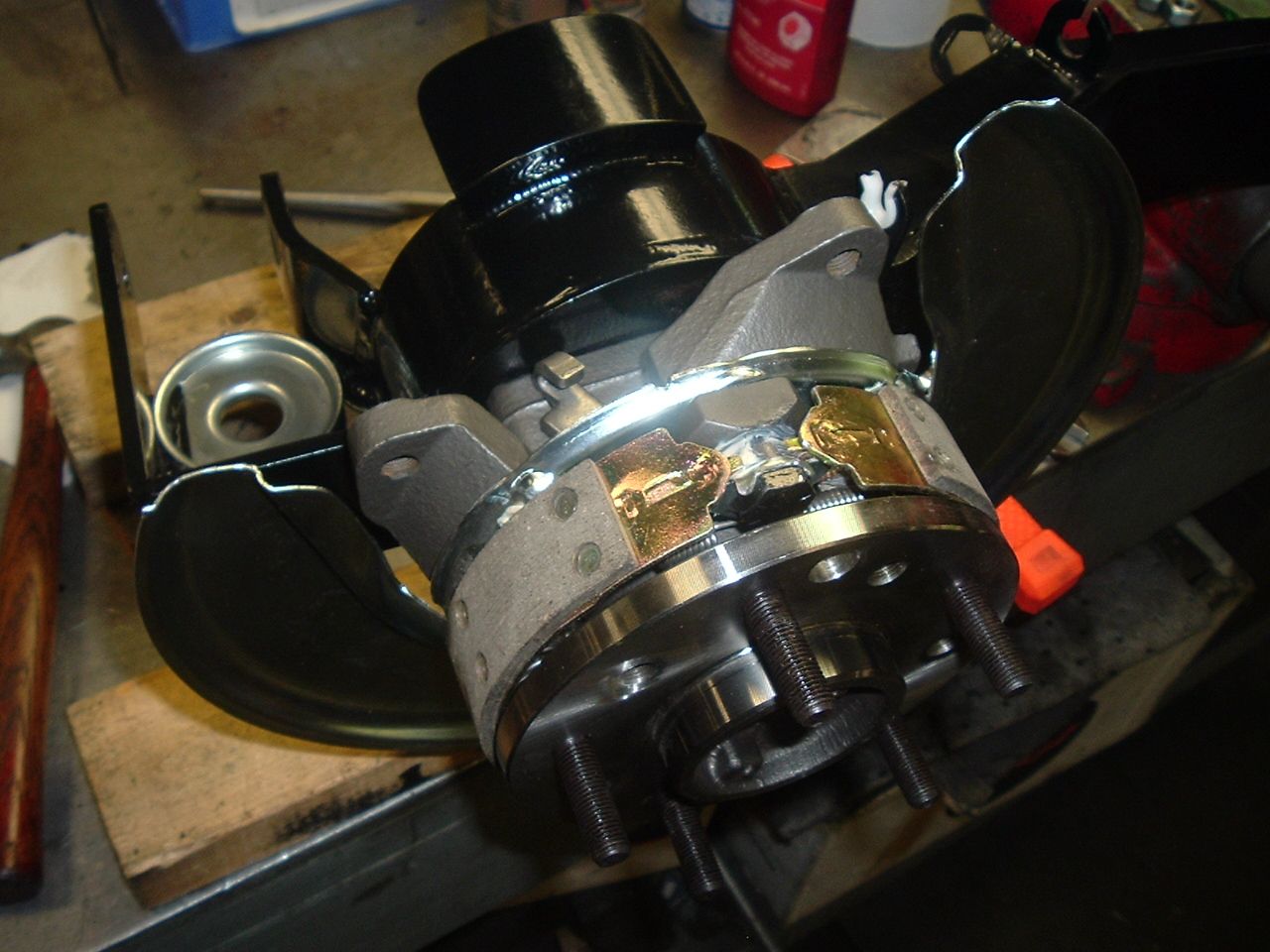

              I did find this picture of the bracket. This is on a set of offset arms but the bracket it a stock one.
