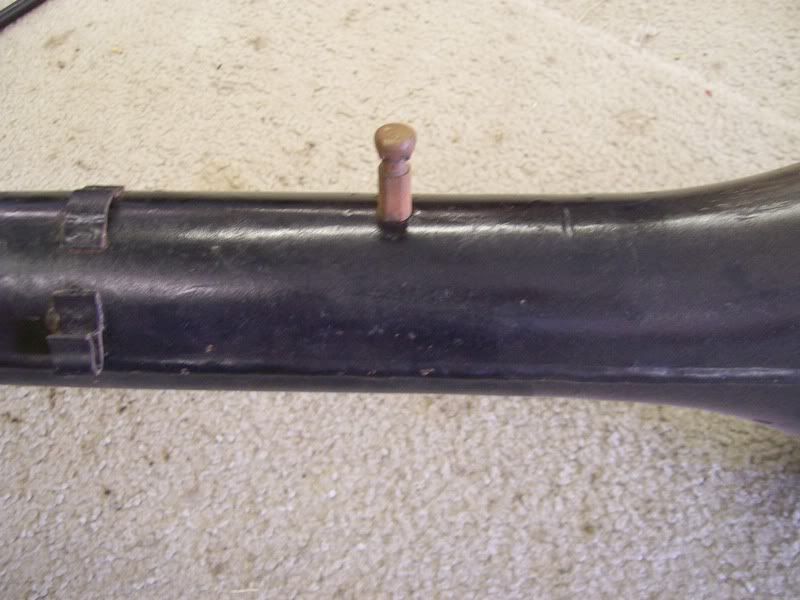

              A true positraction rear will also have a big P cast on the driver side of the center case, as below.
              And the filler plug will have a round tag which instructs using positraction fluid.
              The NON-posi axle housing will have this style of a vent instead of the long vent tube.
