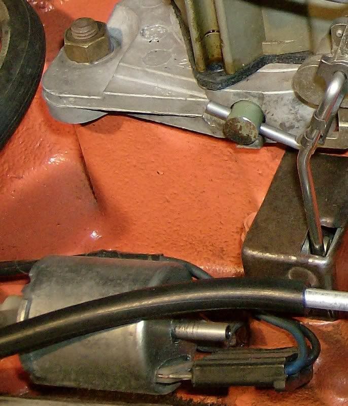

      Could this be it? My 70 350-350 non A/C.....
          What is that? Looks like a vacuum hose connects to it somewhere. Something for emissions?
          Whatever it is I bet that's where the wires go. Rich said light blue, yours seems dark blue, but I'd bet engine heat faded the blue on his.
          Rich
          • Dennis D.
            • March 1, 2000
            • 1071
            Re: 1970 engine wire
            Rich

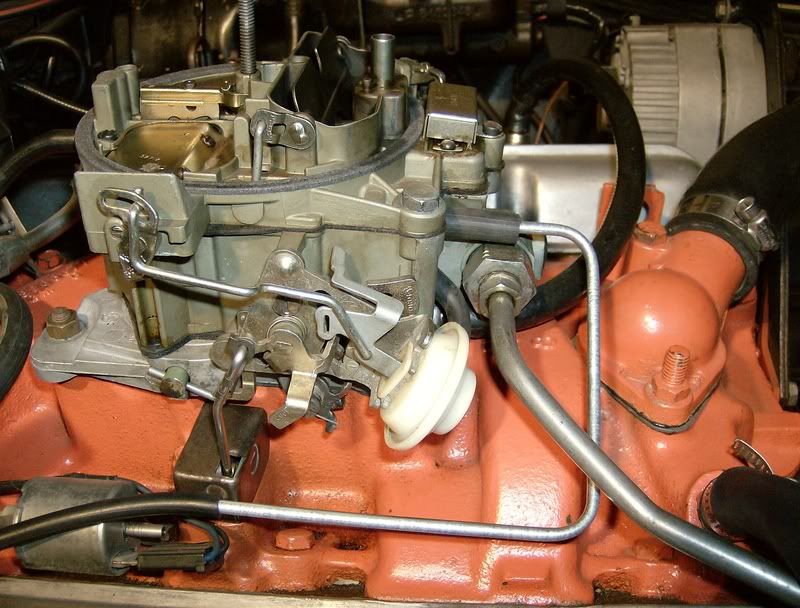

            Connector for the TCS solenoid. I have the front vacuum line bypassed to get full time advance. It IS a light blue wire. May come accross darker in the pic. Also locates on the AC compressor side.
            pic courtesy Stan Falenski

              • 43285
              Originally posted by Richard Harris (19748)
              Hi,
              I am working on a 1970 coupe 350/350 4 speed with A/C. It has all available options except tilt and telescopic.
              I need help identifing a wire and were it goes in the engine compartment. The wire comes out of the harness from under the wiper motor. There are two wires, one wire is light blue and the other is black and they are wrapped together heading towards the ac unit on the passenger side of the engine. Hoping someone can help out.
              Rich Harris
              Rich------
              Many of these TCS solenoids were removed many years ago by owners wanting to improve driveability and fuel economy. Nobody in their right minds (save for restorers who are usually not in their right minds, anyway) would want one of these things in functional condition. Some emission control systems unnecessarily get a "bad rap" but this TCS system is not one of those. It's deservedly despised.
              Did someone cut off the connector from the wires?

                Dennis,
                What specific method did you use to bypass the front vacuum line?
                James

                  Dennis,
                  I think you have your front and rear hoses connected wrong.
                  The port on the front of the carb is ported vacuum and should be connected to the other side of the solenoid.
                  The hose that is connected to the rear of the carb (i'm pretty sure) is just opened to the atmosphere (no vac).
                  On the solenoid - the atmoshpere connection is in the front where the wire connects, it should have a small square foam block glued and covering the nipple. The vacuum source gets connected on the side that has the two hose connnection.
                  I'm 99% sure - but not 100% - so hopefuly some others will chime in.....

                      I simply rum a direct line from the front port of the carb, (Bill that is the correct configuration), to the distributor as my first photo shows and leave evrything else connected as Jim mentioned.

                        Dennis,
                        Great picture, that is the wire.
                        Rich
