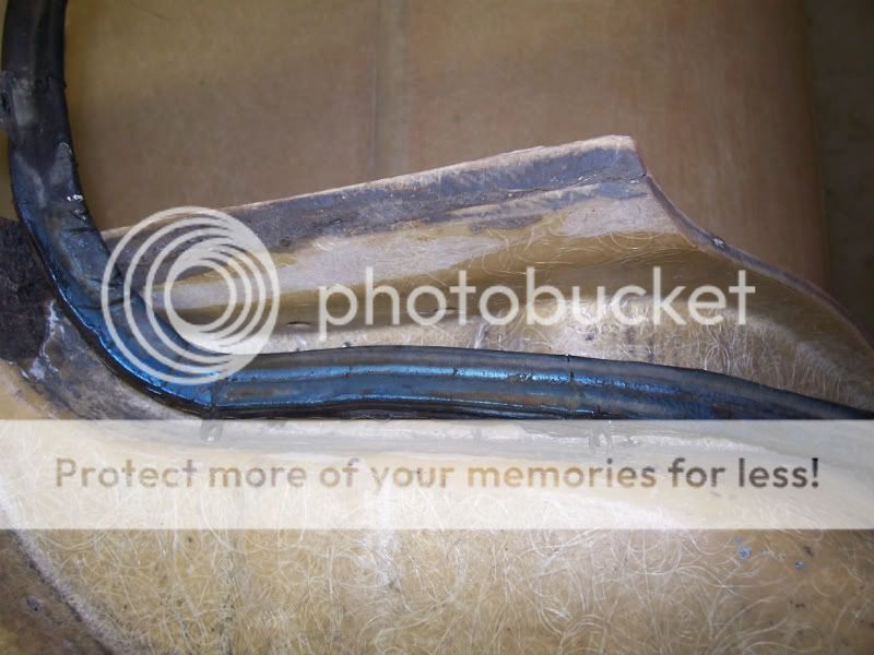

                        The original weatherstrip for my Dec. '58-built '59 has metal clips (built into the weatherstrip) that go into those 3 holes.

                          Re: C1 Door Weatherstrips
                          Thanks For The Pic! This Is What I Understood To Be The Correct Molding From Representative Of Corvette Rubber. They Did Not Reproduce This Rubber With The Clips As Original. Cost Effective For One Year Run.
