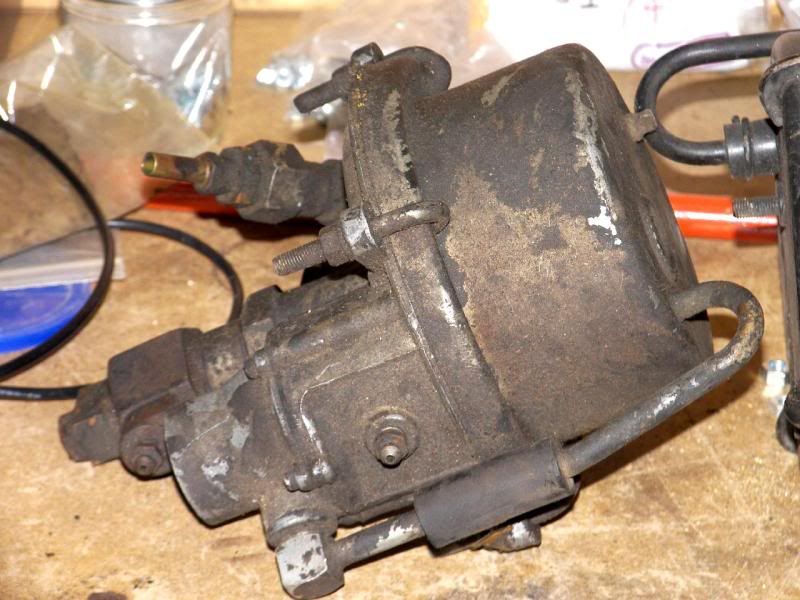

              As an added note, the Sebring prepared 57 Vettes were equiped with power brakes (probably installed by SEDCO).
              As I understand it, the stock master cylinder fed into a booster that was mounted low on the left side, above the left splash pan. The booster was also supplied with manifold vacuum from the engine.
              I once saw a knock out gorgeous 57 Cameo that was more or less pure stock which had this type of pwr bk setup added and the owner claimed it was a factory option.
              That owner was correct.
              In '57 RPO 412 got you power brakes on full size Chebbies.
              If you ordered an automatic transmission also, you got the kind of booster we are all used to seeing, one that sits between the firewall and the master cylinder.
              However, if you were content with a manual transmission, you got the kind of booster you described, Tom. It mounted on the firewall beside the master cylinder and kept the brake pedal at the same height as the clutch pedal.
              This is what the booster looks like:
              I believe this kind of booster went by the marketing name "Hydrovac" whereas the booster used with automatic transmissions was known as "Treadlevac".
              Jim
