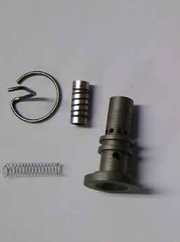

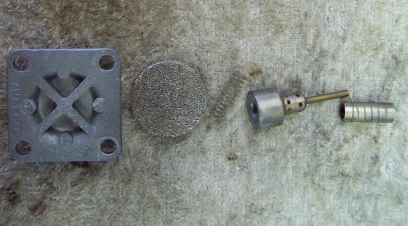

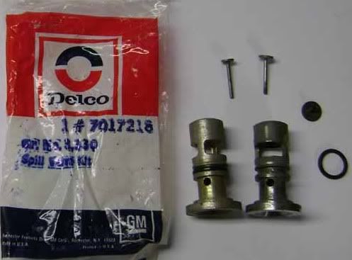

                      Glad you have the thumbtack style spill valve. Anyone want to see this part and the original just look for nice photo in Corvette Servicing guide. JD
                      As far as I know, this is all 4 of the versions of spill valves that were used 57-65. Of course, the bottom one (latest version) is the "Thumb tack" style. The third one is the better of the two sleeve types.
                      THE TOP ONE WILL ONLY FIT THE SAND CAST FUEL METERS, The remaining valves are interchangeable in any of the die cast fuel meters.
