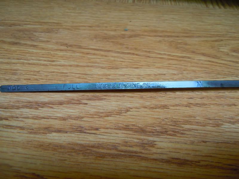

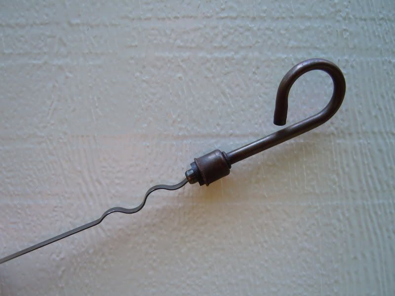

        I miss spoke. The new dip stick has the dimple/indentation. I am not sure if the one on the left was orginal to the car, but it was on the car when I bought it 6 years ago.
        WHICH IS CORRECT?
        Attached are pics.
        Do you konw what color/finish the handle should have?

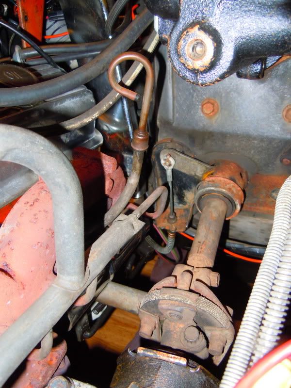

        Also I have attached a picture of the dip stick tube. I think it is to shiney. Your thoughts

          I believe the correct dipstick for the 1972 Corvette should be stamped "ADD", "FULL", "USE SE ENGINE OIL" as well as a "M" (or possibly "E", depending on the manufacturer) and WITHOUT the dimple in the handle. The "A" dimension should be 20 5/32" and the "B" dimension should be 20 59/64". The "M" dipsticks have a black plastic tip at the end of the loop on the handle.
          The 3862730 dipsticks sold over the counter in the 1980's are stamped "ADD 1 QT", "FULL", "USE SE ENGINE OIL", "3862730" and "M" and do have a "dimple" on the handle.
          I believe that the 1969-1971 dipsticks are stamped "ADD", "FULL", "USE GM6041-M-QUALITY MS OIL" and "M" (or possibly "E") WITHOUT the "dimple" on the handle.
          The 1965-1967 dipsticks were stamped "ADD", "FULL", "ENGINE OIL" and "M" with a black plastic tip on the handle.
          You should confirm my findings with others before spending any kind of serious money.
          The upper dipstick tube is GM # 3876784. I have several used original tubes if you need a photo. Is the top 2" of your upper tube smaller in diameter then the rest of the tube? I can't tell from your photo.

            Yes the upper 2" of the tube is smaller in diameter.
            What are your thoughts on the finish? Like I said it looks a little too shiney. Do you have a picture of your original tubes that you could post.

              My 3 used original 3876784 upper tubes have a dull gray finish. I also have a NOS upper tube for a 1967 Chevrolet 283/327 (GM # 3900428) and its finish is also dull gray. The 3900428 is 1/8" shorter then the 3876784 tubes, otherwise identical.

                  Here's a few shots of what I believe to be the original from my 72 LT1 (5/10/72 build date).
                  Hope they are helpful!

                      I also believe that the dipstick shown in your photos is original equipment for your 1972. The "ADD", "FULL", "USE SE ENGINE OIL", and "M" are correct for a 1972.

                        In addition to the colored tip - a flat handle stick was also used.
                        Stick markings would be the same on both styles.
