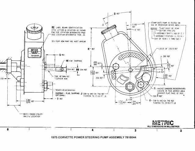

                        Re: Power steering pump for the Judges
                        Here is a scan of the 1975 Corvette Power Steering Pump Assembly 7818044. The only real visible identifier is the label on the side of the reservoir. Any date codes 000XX0 stamped on the side of the reservoir can would probably be covered by the pump mounting brackets. The reservoir return spout on this drawing is generic. The pump drawing was generic for 20 or more power steering pumps. So studs on the back of the reservoir would be generic as well.
                        Jim
