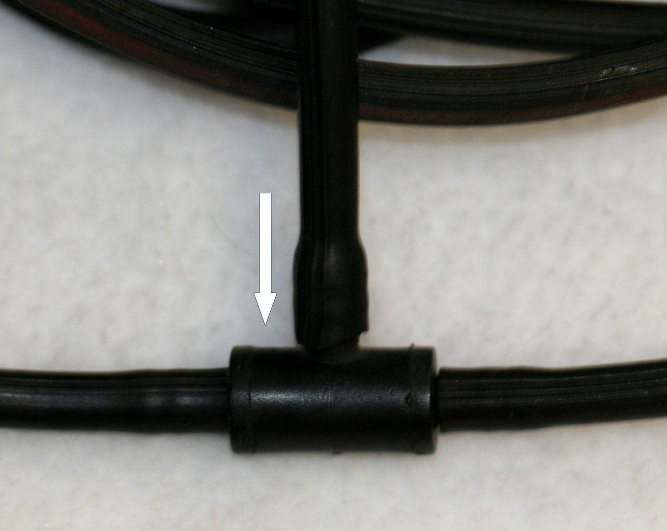

                Just to be sure Joe -- you are asking about the headlamp washer hoses? The barrel shaped T under/behind the headlamps.
                I know what I think the answer should be, and Paul gave you my off-the-top-of-my-head answer, but I will have to go look at my 1970 to be sure. Have some patience I have a lot on my list.

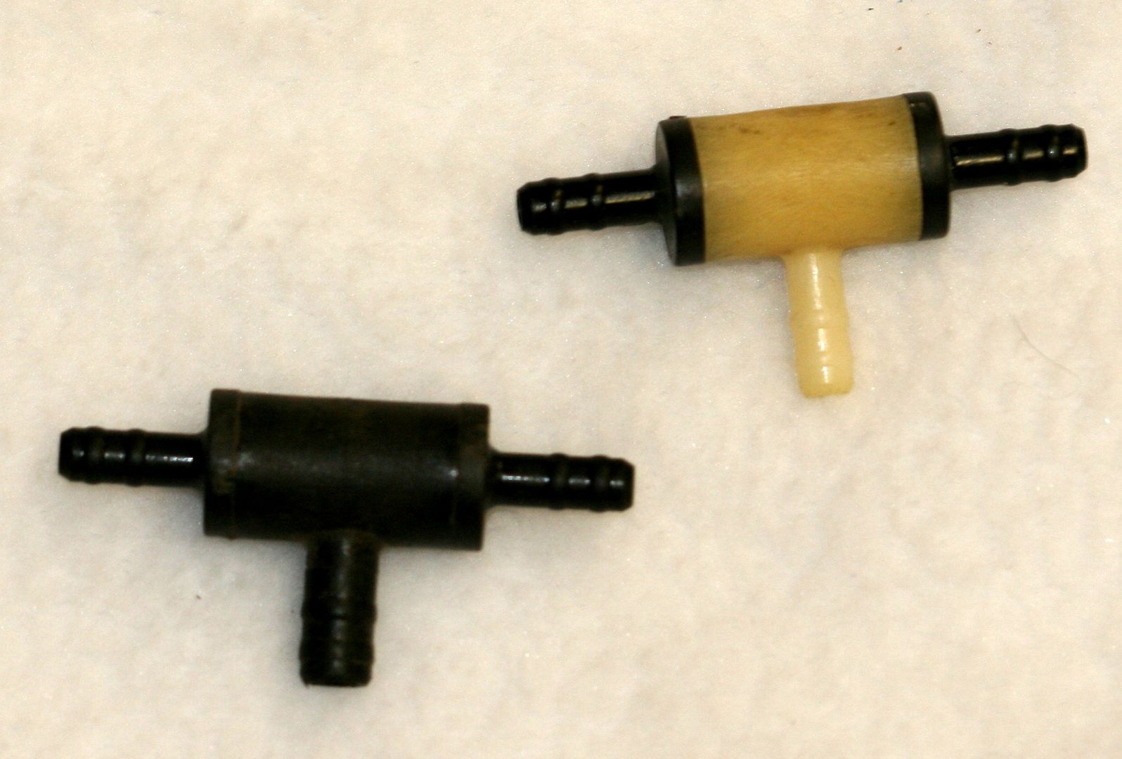

                  If this is what you are referring to...
                  ...I have never seen tape on an original car. I've seen variations of the valve...
                  ...but, I've not seen tape.
                    Shouldn't that valve be a bit whiter?

                        Mark,
                        You probably know this but your white/black valve is 70-71, the black valve is 69. Look at the size of the 3 ports. the 70-71's have all 1/8" ports and the 69's have the 2 inline ports 1/8" and the Tee is 3/16". If you check the AIM's the PT# should change from 69 to 70. This is because of placement of the valves.
                        Rich

                          Re: 70 Headlight Washer Check Valves
                          I most certainly did not know that. Thanks for the education, Rich.
                          Kramden

                              I wish I had taken pictures. My 70 definitely had tape identical to the vaccuum connections. All the hoses were original. In fact, I reused the original red striped hoses.
