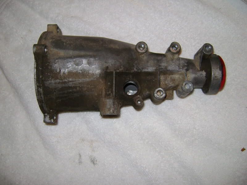

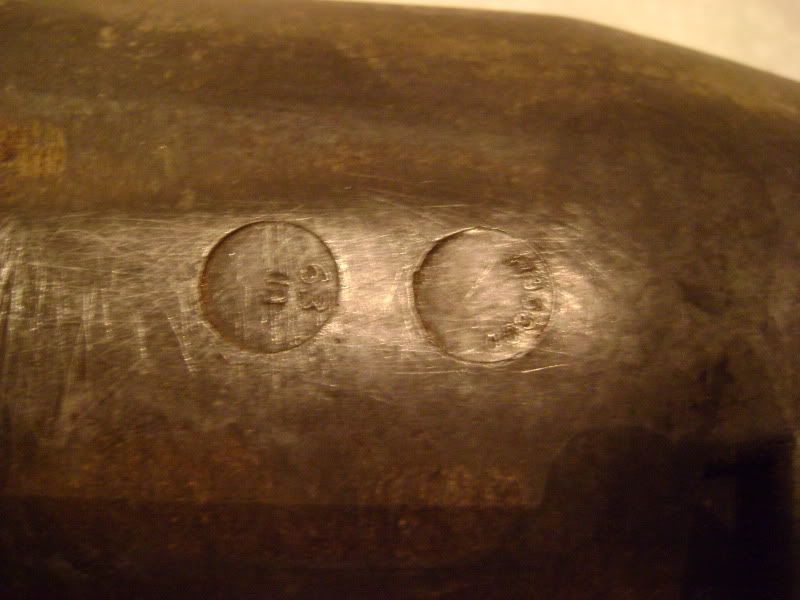

    Does this tail housing fit a '63/4 Corvette with Powerglide? It has the part number 3793800 cast into it and what appears to be a date of 11 63.
    Thank you,
    Todd

    Todd------
    I'm not 100% sure, but I believe it is. The GM part number of the finished extension housing for 1963-64 Corvette with PG was GM #3793803 and I think the casting number for this piece was 3793800.

      Re: Is this a '63/4 Powerglide tail housing?
      agree with joe. mike
