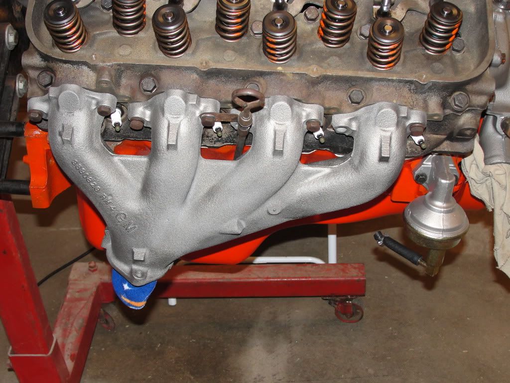

    I sent mine off to Jerry MacNeish for his new aluminum skin process. Then I used the rattle can paint he provides. I think they look pretty good. I plan to drive the car for a while before I restore it. So I don't know how well they will judge. I expect they will take somewhat of a hint. But to me it's worth it because they should never rust, at least on the outside. I was planning to include a picture, but I don't have my thumb drive with me. Hopefully I will have it for you tomorrow.

        Bob,
        Here's a couple of pictures of mine:
        I see some darker spots in the pictures that I don't remember being on the real thing. Maybe that's just the lighting.
        Joe

          Re: Exhaust Manifold Restoration
          Joe
          Or maybe that was just wishful thinking on my part. Some spots are darker and shinier than others. I assume that was due to poor rattle can technique. I guess I'm not a legendary restorer just yet (not even in my own mind)! What did I do wrong?
            Joe
            I'm sure that when you finish by painting the heads and exhaust manifolds orange it won't be seen. Small changes in the paint or coating tend to be covered up by the orange. Then when it burns off it really looks like (delivered from the dealer).

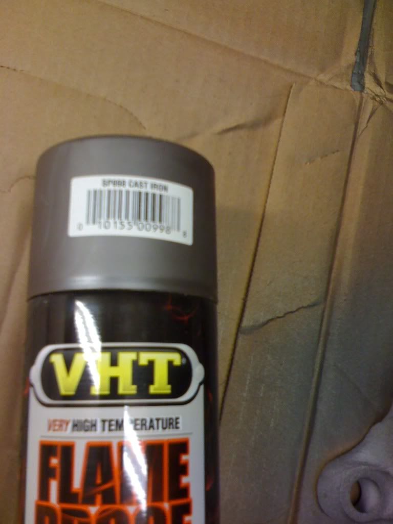

              Joe, what type of paint does Jerry supply in a rattle can? Thanks
                JR
                Joe,
                I agree that most of the exhaust manifold would have been painted orange at the factory. But I only plan on painting down to about the bottom of each individual runner. So do I need to strip them and start over or what? What should I have done to ensure a more even application of the paint?
                  Michael,
                  Here's a crappy photo I took from my phone.
                  I can take a better one if you like.
                  Joe
                    Joe, the picture is good enough but I do have one question. On the cap before cast iron what does it say? Is that a number or a word?
                      Michael,
                      That part of the picture is really blurry. It looks like it might say "8P998" or maybe "SP998." I think I will edit my previous post to use a PhotoBucket version of the picture since the tech board compressed an already poor quality pic for me.
                        Joe,
                        Joe
                        Just paint the orange right over the top of what you have there. When you light this puppy up, the look is going to change rapidly anyway.
                          A key point here is whether you can see a color/hue difference between the surface of the 'painted' cast iron exhaust manifold and the un-painted portion of the cast iron cylinder head it's bolted onto?
                          If your answer is yes, then don't balk when the judges take originality points for there being some 'strange/foreign' coating on your exhaust manifolds that's inconsistent with factory original production...
