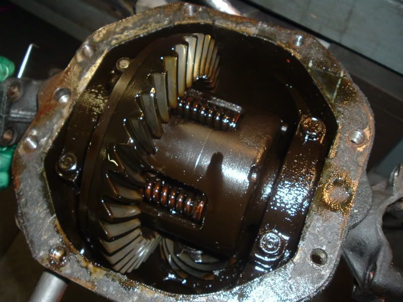

        As Wayne stated, the 63-64 used the Dana posi when so ordered. They were weak and many are gone by now but I still see them. You can't get parts for them and you wouldn't want to build them even if you can. They have long thin springs on them compared to the Eatons.
        The 1st design Eaton were better but not by much. I think 1/2 of what I see are cracked.
        The 2nd design were much better, they didn't crack as much as the earlier ones and were generally exposed to more power as the BB cars came in and the cars were built stronger then stock.
        The spiders used in the 65-70 were not as good as the 71-79 but the clutches were solids and much better then those snowflakes used in 71-79.
        If you're building a mild cruiser then a stock 1st design is ok to use. Be sure it's not cracked.
        The new loaded are ok for a mild car as well but I'd never recommend them.
        The best to use are the ones build to the application.
        Here is a stone stock 64 posi. I removed it and it wasn't broken but it ended up a paperweight.
        Keep in mind if you do have one of these then the ring gear and pinion yoke are also obsolete and you'll have to upgrade them.
