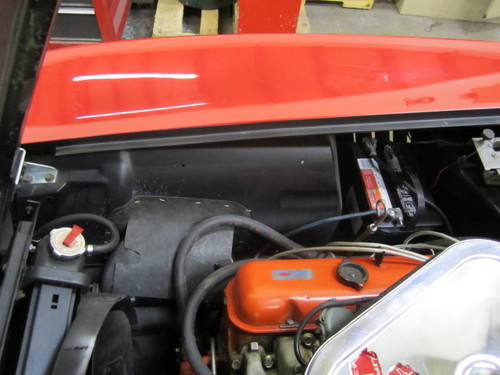

              Looks like they yanked the ad and reposted it. Is this the same car?
              Isn't the battery supposed to be on the driver's side?

                  Patrick - That's the 66 BB part of the car (battery tray)

                    by the way, Patrick I believe all 67 435's had the battery mounted on the passenger side, That's where the battery to my 67 435 is located, and my car is WITHOUT QUESTION an original 435.
                      Jacob, yeah I didn't realize this thread was started back on April 5th until just now. I have a '67 L-79 and if they could put a battery door on the inner fender of the big blocks for ease of removal, why couldn't the bums put that door on the small blocks as well?

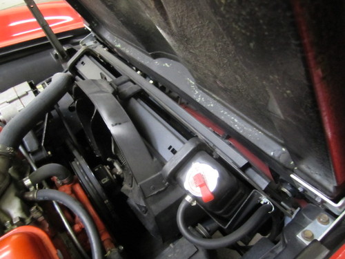

                          I'm not that familiar with the underside texture of mid-year hoods, but on this one, it looks a little too rough and uneven to be press-molded. Or is that the normal appearance?

                            ................I have a '67 L-79 and if they could put a battery door on the inner fender of the big blocks for ease of removal, why couldn't the bums put that door on the small blocks as well?
                            But the '67 big blocks don't have a battery door on the inner fender.
                            My '65 L79 air coupe has a door on the inner fender left side for battery removal, but it's anything but easy. Gettin' the battery out of one of the '67 BB cars is a cakewalk by comparison.
                              Absence of holes in the fender skirt for the heater hose bracket used on big block?

                                Isn't there suppost to be a rear stabilizer on a big block, or am I missing it
