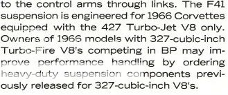

      This is from Corvette News, Vol. 9, no. 4, p. 10:
      (edit: The price guide for 1966 shows 425 only...)

        Larry -
        In '66, F41 was only available with the L-72 (427/425hp) engine option.
        I thought the rear bar and different front bar came on all 427s ?
        Bill
        • Wayne M.
          • March 1, 1980
          • 6414
          Re: 1966 F41 Suspension
          Bill
          You are correct; the 9/16" dia. rear sway came on L36 and L72. Just like J56 H.D. brakes. Front sway heavier (15/16" dia. versus 7/8) with F41, though.
