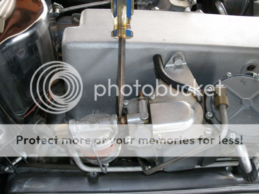

    I noticed some fuel seepage on my FI fittings at the fuel meter/filter pictured below at the end of the screw driver. What is the best sealer to use on the fittings? Can I clean the existing areas around the fittings and apply a sealer? I did not want to take everything apart if possible. Thanks, Larry

    You can't seal those fittings without taking it apart. Disassemble those tapered pipe thread fittings, clean them, use a light film of Teflon pipe paste (NOT tape), re-assemble, and wipe off any excess that shows.

                        Larry, YOu want to be very careful at that inlet fitting. If you overtighten the fitting you will break/crack the fuel meter cover. I see that your cover has alterations to it now so you don't want to take the change of ruining it.
                        I use Loctite 545 on the inlet fittings with great success. Available at industrial tool supplies such as Travers, MSC,etc.
                        First of all make sure the fittings are spotless. Then shake the bottle and apply the 545 very thin with a Q-tip. Since you have a carburator filter I would first install the fitting in the carb filter. Then I would gently install the assembly-screw the assembly into the fuel meter inlet area that you put the Loctite 545 on. As I said before don't overtighten. Let the Loctite do the job. Wait a day or so and you are set.
                        Never use teflon tape for the inlet fitting. Here is why. The casting is a 1/8" straight pipe thread. The fitting is a 1/8" tapered pipe thread. It's a crush fit with zero room for the white tape. I see some of the crew likes teflon paste. Not going to knock it but I would be out of business without Loctite 545 as it's my favorite stuff for fitting. Wipe the excess offf with a Q-tip. Good luck, JD
