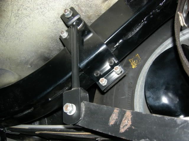

    While surfing the internet a few nights ago I came across an article by David Bartush that had pictures of the Houdaille frame shock brackets used on the 1956 Sebring Corvettes. Before I could save the article, someone else used the computer and it was gone. Now I can't find it.
    Does anyone have a drawing, photo, etc. of either the frame shock clamshell brackets or the Houdaille shock mounting bracket on the leaf spring shock plate for the Sebring cars? If not, does anyone know how to contact Mr. Bartush?
    John Neas and Joe Trybulec have offered an inspection of their cars which have the Houdaille shocks. I was hoping a picture or blueprint drawings could give me a head start in building these before meeting with them.

          Re: 1956 Sebring Corvette Houdaille Shock Brackets?

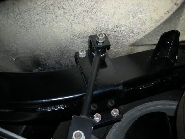

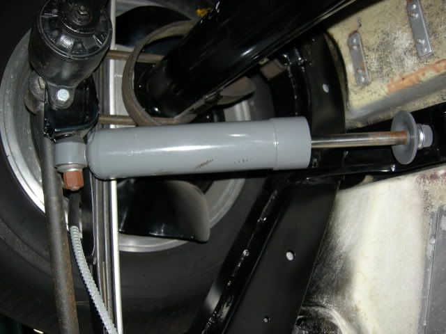

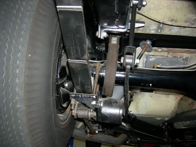

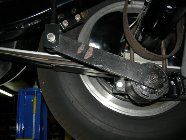

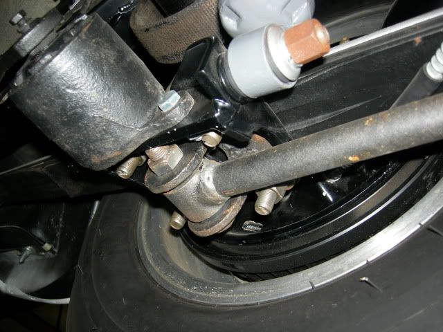

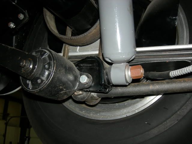

          Tom,
          Here are several pictures of the Houdaille Shock Brackets.
          Regards
          • Tom W.
            • December 31, 1976
            • 74
            Thanks John, This is exactly what I needed. I really will come to see your car eventually. Since mine isn't running yet, any chance you need someone to stretch the legs on yours?
