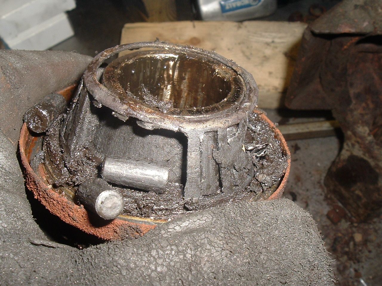

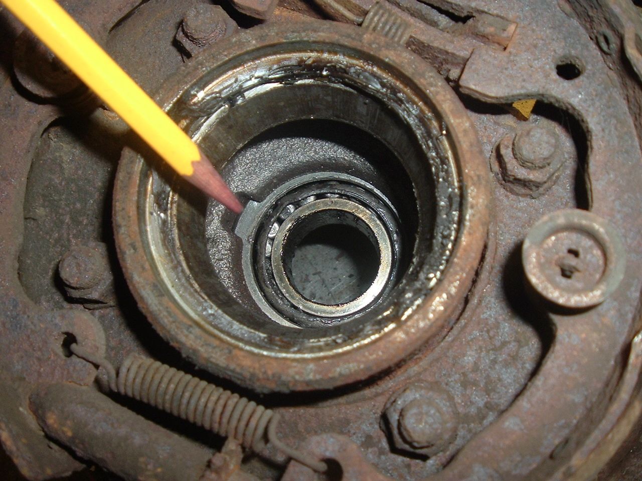

      I went and copied the picture from the '66 I just did. Here you can see the inner bearing before I tapped it out. The well is dry and the bearing looked together. These were the original Hyatt bearings.
      Here it is after I picked up the arm after tapping out the bearing. The spindle was removed so just the seal and shield were holding it in place.
      Close up look
      I thought I had pictures of another bearing setup that the grease tool was used on, clearing showing the Damm of hard packed grease stopping the new grease. I couldn't find it.
