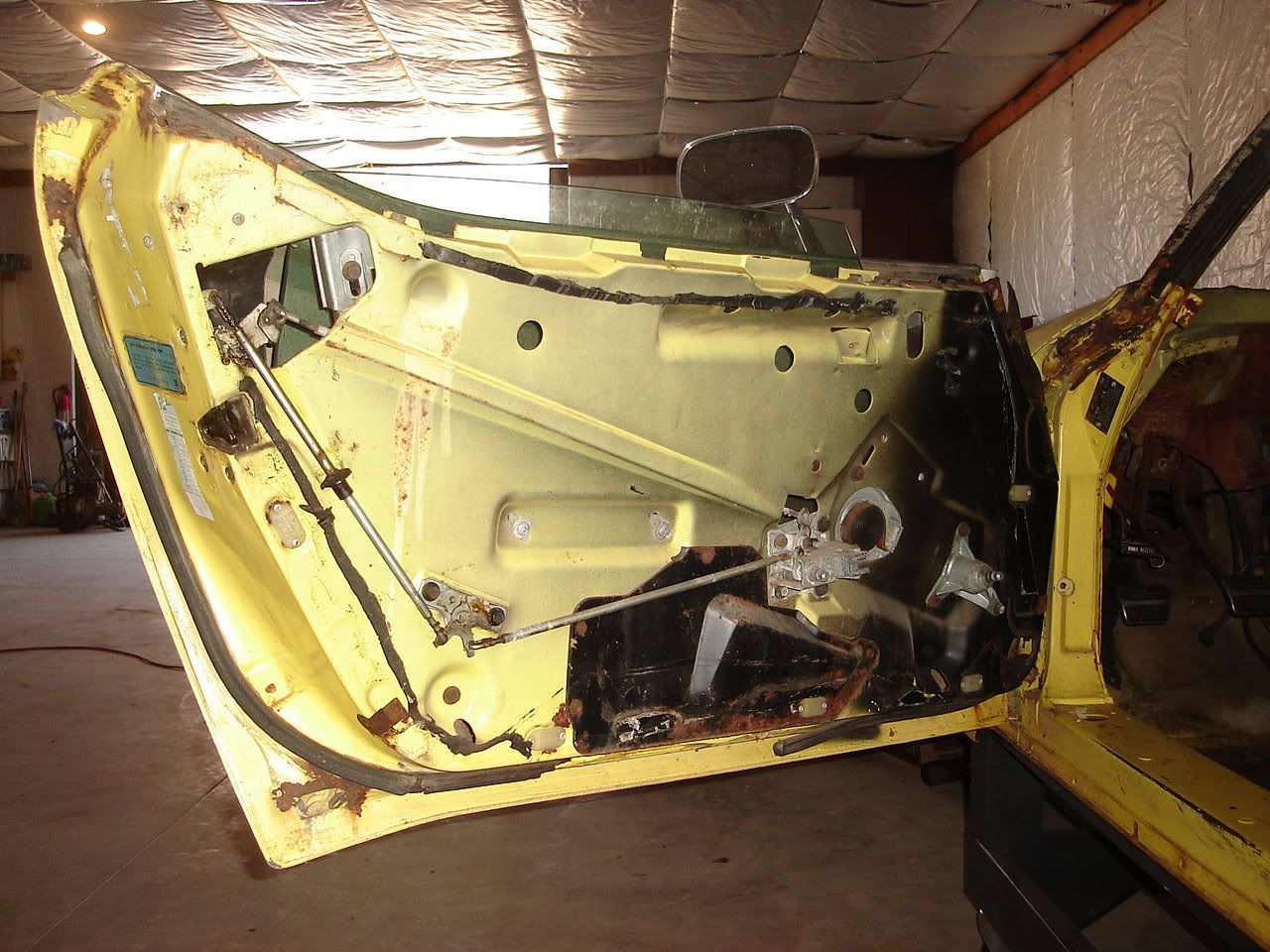

                  Re: Semi gloss black area on doors
                  This photo should help. From an original late 71 car.
                    Thanks Terry, you have come to my rescue again. I would like to put the blackout and weatherstrip on before mounting the doors so this is near the top of my list. I plan to reunite the body and chasis this month.
