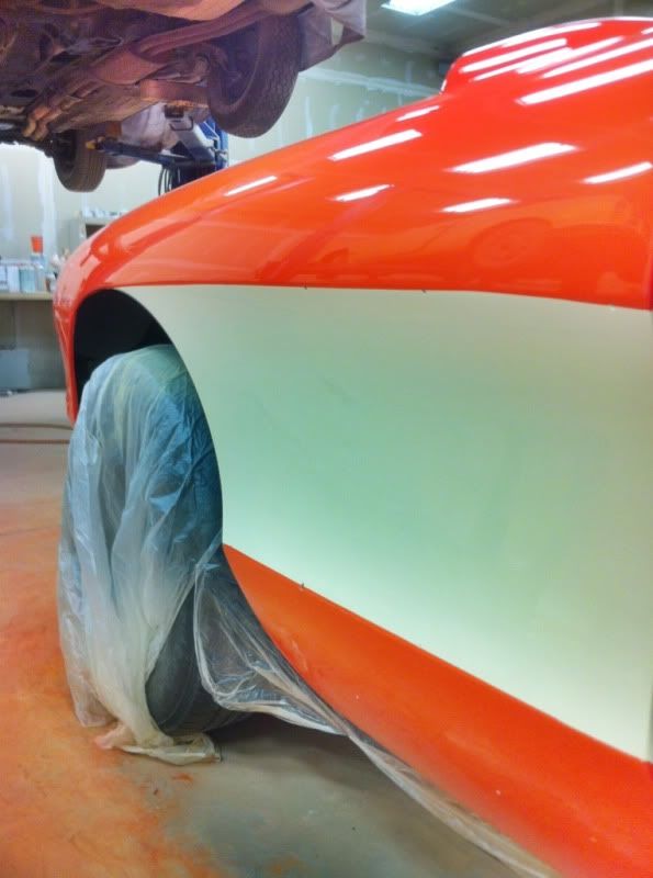

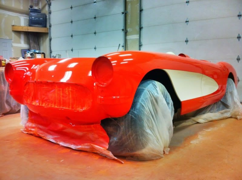

                      Here's how she's lookin so far...
