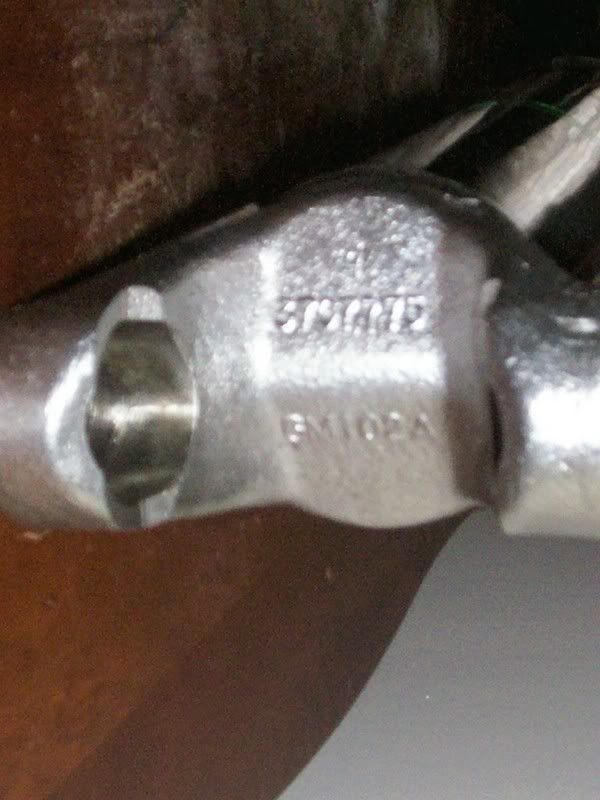

    Hi,
    just cleaned my shafts, I searched the forum and looks like they are not original, which starts w/ 38xxxx, below is my part #, can someone id them?
    1) half shafts - 3707775
    2) drive shaft - 3742995
    Also is the drive shaft identical in size and lenght for auto and 4-speed?
    Danny

      thoes are the numbers cast into the yoke ends, they are known originals

        The numbers I posted are for the complete assembly. Don't have the yoke numbers which correspond to a drive shaft and was unable to read those on either of the originals I have. (stuff in the way).
        My reference (Chassis Restoration Guide, Tripoli) shows both drive shafts at 29 7/8" Same source notes no part number for 63-67 just paint rings.

          I believe the numbers you are reporting here are the FORGING NUMBERS for the yokes. They are not the part numbers for the driveshaft assembly. However, I think the half shaft yoke forging number is actually 3797775.

            Thanks guys, glad to hear that those shafts are original, I am going to paint them now..
