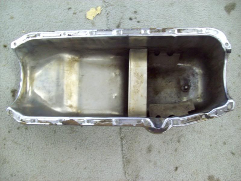

    I just bought an oil pan off ebay for my 1960 restoration. It was advertised as part number 359937, which is a service replacement trap door pan for 57-62. I have looked at the Restorer article that Tom Dingman did and also an article from Loren Lundberg and by comparison the one I bought seems to be correct as the service replacement trap door oil pan. I attached a couple of photos.
    It is of course used and has a number of dents and dings which I would like to repair. However, there are some dings that I think are original, e.g. creased in the sump edge that were created when the pan blank was pressed into the mold.
    Do anyone have closeup pictures that you could send me? Particularly of around the outside of the drain hole and outside of the sump area from the different sides? email: donh45@yahoo.com
    Also, how best to repair? I can hammer out some of the larger dents, but what filler should I use for finish repairs? Will Bondo like material be OK? Obviously I will only use filler on the outside, then sand, prime, and paint.

    Is it a trapdoor pan? I do not see the spotwelds on the sides of the deep sump that would indicate the side baffles.......

      Yes it is a trap door. I marked the spotwelds in red dots in the two pictures below. There is actually another one on each side just on the curve of the sump where the side baffle is spot welded, then four more in the front of the sump, or bottom of the trap door assembly.

        I was unaware that GM had ever re-issued this pan. Are you sure that it's not an original??

          Sorry, I don't understand your comment. This was advertised as a part number 359937 trap door pan. From what I can see, it has the same grooves as the one in your article.
          What do you mean by "Are you sure that it's not an original??". Do you think it could be an original 1960 trap door pan?

                      I realize this is not a correct original for 1960 high performance engine. I do believe it is the service replacement trap door pan. It is much more closer to correct than what came in my car, which I believe was from a much later passenger car.

                          Once again for comparrison, here's the service replacement pan for 57-62 Vettes that I bought back in the early 70s. This is going on the 383 that I'm current building to replace the VERY tired 350 in my 51 Chevy.
                          Notice the difference in the indentations on the sides compared to the pan above.

                            Thanks Tom,
                            I assumed the one I have was a replacement trap door pan, not an original, based on the article in Fall 2009 Restorer. The photo below is from the article and is described as a GM replacement trap door pan for 283. Mine matches the description of this one, i.e. four grooves on the driver side and three on the passenger side.

                              You can use commerical grade JB weld to repair the dents. You can sand or gind it after in dries.
