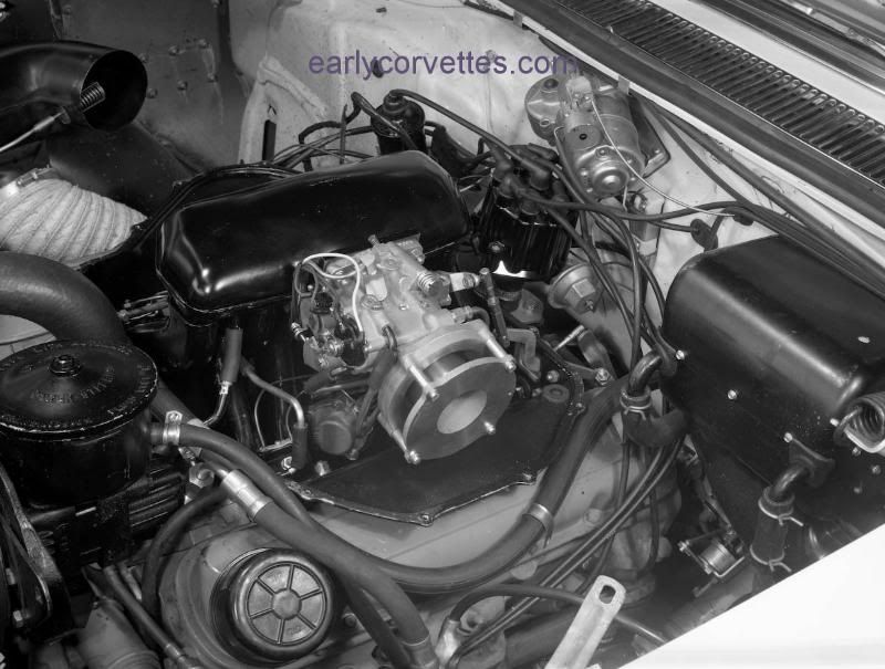

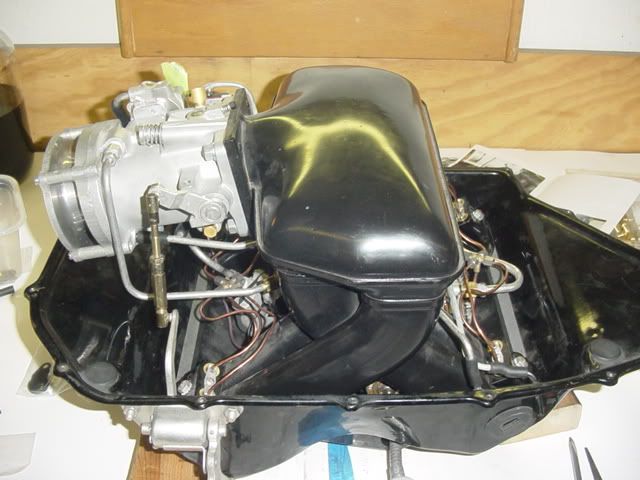

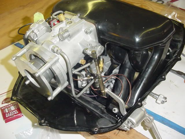

                      Here is a 57 Pont FI, covered and uncovered. The fuel meter was positioned UNDER the plenum, rather than on the side like a Chevy unit.

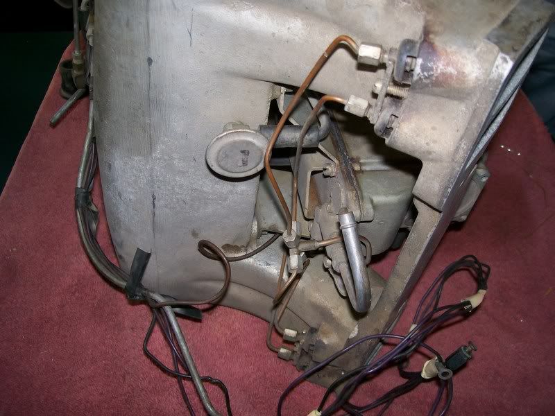

                      This is a 58 Pont unit that one of the Okla NCRS chapter members brought for "show and tell" at an Okla Chapter meeting.
                      The hi-press pump is on the side of the fuel meter instead of the end as on Chevy FI fuel meters. Notice that all Chevy fuel meters have the bosses cast into the side for machining to install a pump on the side for Pont application (or Olds application, ya, that's right, there was a 57 Olds prototype FI unit, check the pictures in Ken's book).
                      Do any of you owners of 7380 units recognize that solenoid?

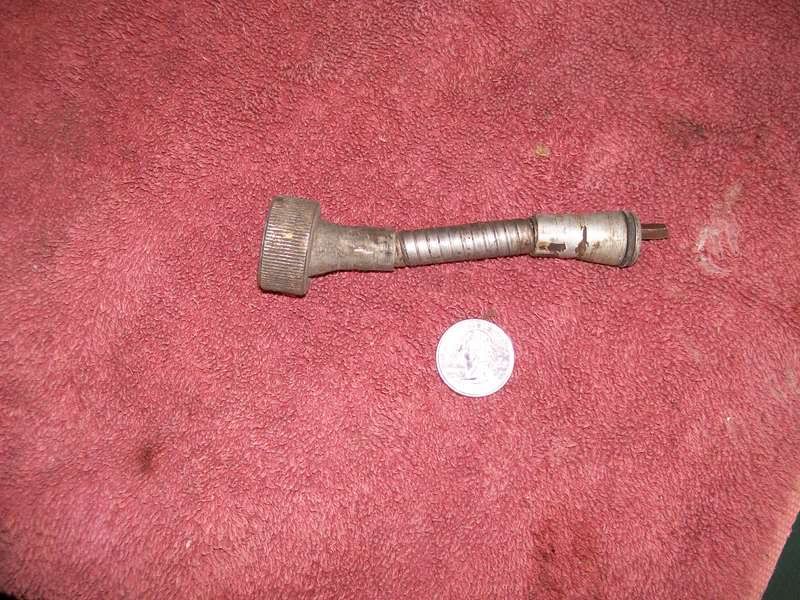

                      And here's the short Pont drive cable.

                        Tom Parsons etal. Notice the high pressure pump on the Pontiac unit does not have the weep hole on the bottom of the pump. That's Pontiac only. Same pump as the Chevy/Corvette though sans the weap hole. Seems Pontiac with the turkey roaster didn't want gas floating around to catch on fire.
                        Appears that the Pontiac munit has zero clearance between the enrichment diaphragm and the backing plate. Manual says should have about .040". What do you think Hanson?
                          Notice the maroon paint/coating on the rich/lean stop nuts? Rochester put that there so if a unit was returned, they would know that it had been messed with by dealer/owner.
                          When I rebuilt the 7017380 FI unit from the 1500 mile 65 green/saddle conv., it had the same maroon coating on the nuts. I have closeup pic's of it somewhere around here.
