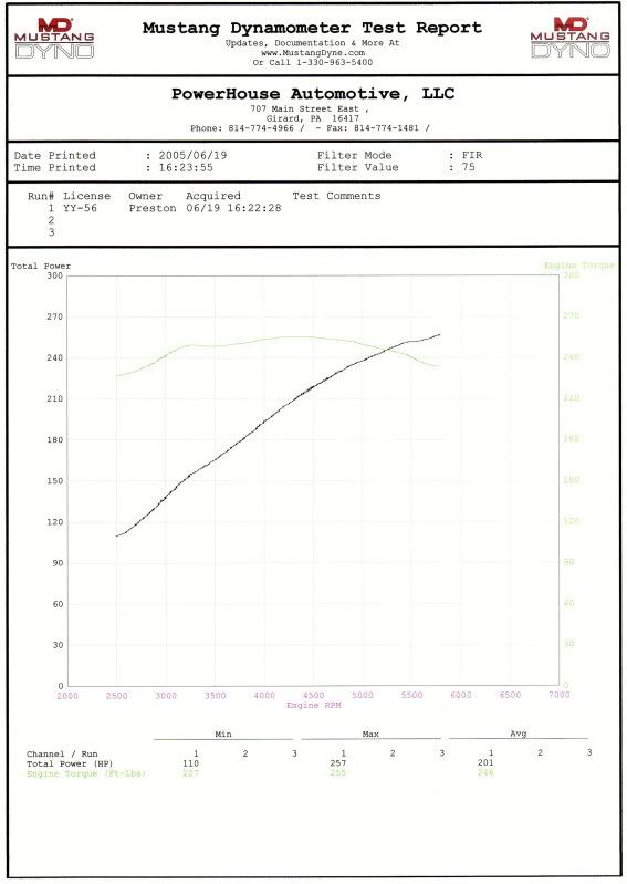

    72 LT-1 Dyno Run
    Was wondering if anyone else has Dynoed their LT-1.
    Mine got 257HP @ 5700 RPM I limited them to 5700 is the only reason they didn't keep going. I'm sure it would have been higher because it was still building at 5700. So much for factory specs.

    Ken,
    Was it just your engine dynoed or was it where you run the rear wheels on the dyno? Rear wheel HP will be a lot less due to friction losses.

      What this a lab or chassis dyno test?
      Is the data observed or corrected, and, if corrected, what convention was used?
      There is what appears to be a torque curve, but the scales don't make any sense for either a lab or chassis dyno test.
      On a Dynojet any decent 327 should be in the 270 lb-ft ballpark for peak torque regardless of power, and a 350 should be near 300, but in my experience, Mustang chassis dynos read 5-15 percent lower than Dynojets, and I don't recommend them. Dynojets give much more consistent readings, so SAE corrected data can be compared to other Dynojet tests from different times/places.
      A dyno chart with no explanatory information about the test or the details of the engine configuration and test setup and correction factors is worthless for comparison to anything else because it totally lacks context.

          This was with the engine in the car with everything hooked up and running rear wheels on the dyno. Engine is totally stock except: no A.I.R. and I put a Mallory distributor in.

            Those are strong numbers for a stock 72LT1, putting out its net rating to the wheels.

                    Ken, Is a Mustang Dyno a bench or chassis Dyno? I would presume it is a chassis dyno reflecting power to the rear wheels.
                    At 5700 RPM's, if your LT1 has a/c, you are into hazardous RPM's for the a/c system.
