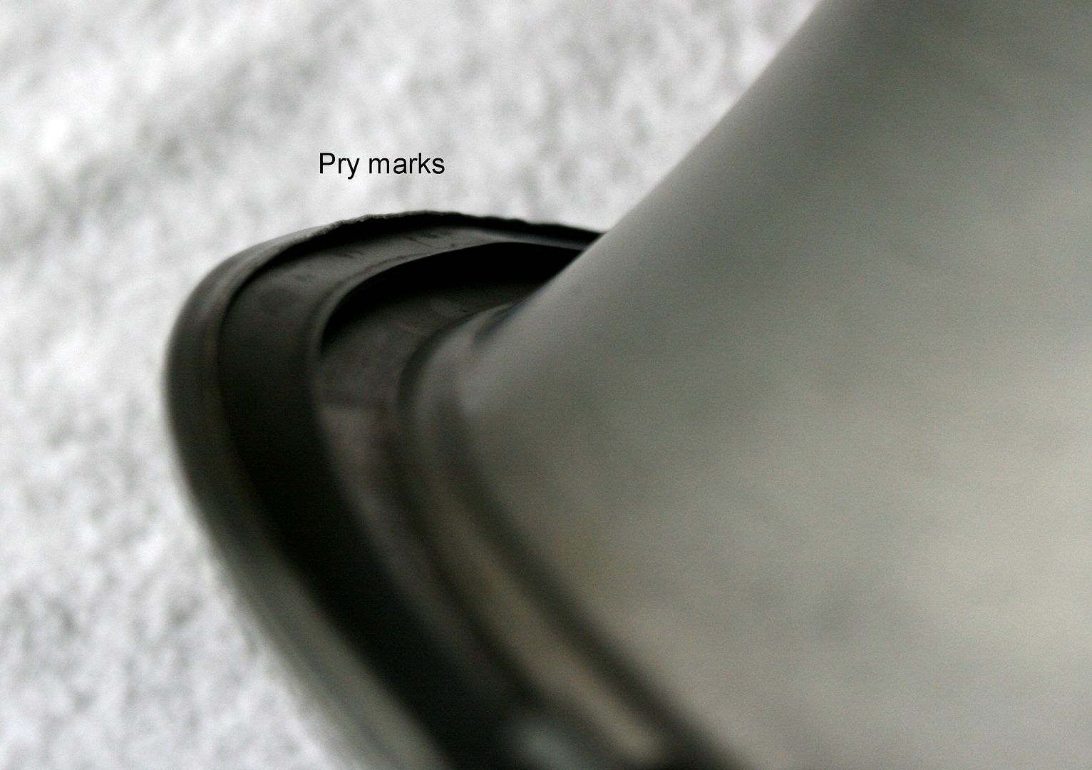

    Thought I would post this to see if anyone is interested in discussing the finer points of these trim ring bands and clips. I have seen questions posted over the years and like many others, I became interested and tried to research what is and isn't TFP.
    I have come to the conclusion that, at least for 68 and 69, the crimp around the entire circumference of the band should be, for the most part smooth. There were areas that were not as tightly crimped but they were few and far between. This is shown below.
    I have seen rings where the restorer did a very professional job as they 'uncrimped' the band just enough to move the clip orientation to represent TFP. Unfortunately, even when such workmanship is evident, the original tightness of the the factory crimp isn't returned and there is evidence left behind. I would think it would be extremely difficult, if not nearly impossible, to 're-crimp' to TFP. The next two PICs show a very professional job of re-orienting the clips.
    The last couple PICs show a later service replacement (not 68/69) which is a typical example of a poor job of moving the clips. I believe this was never TFP in 68/69 and, most likely,through at least 1972. There was a time I thought maybe some assembly line rings were smooth and others were not but, I no longer think that is true based on original examples on and off original cars. If a ring shows pry marks such as the last two shots, it is my opinion there is no way (to borrow from Jackie Gleason) this is TFP. There is a well known restorer that would disagree.
    Anyone thinks I'm all wet, feel free to let me know...my wife does daily. I just wanted to stir some discussion and perhaps debate. It's the NCRS way, afterall.

    The crimps of the original trim rings from the orange 72 are just like the 68/9 variety you show. In addition, the spot welds used to retain the clips are different for early rings with the clip at the hole than those used for later rings. The early rings are a bear (or worse) to try and replace the clips as compared to the later rings. I gave up and just replaced the ring with the 2 broken clips.

      You really don't have to pry the crimp up to re-orient the clips.
      If you just run a blade under the lip to slightly relieve some pressure without prying up, then soak them in WD-40.
      Then take a rubber mallet and go to it.
      You can move them around without pry marks and is very undetectable.

        Mark,
        Nice job on showing and discussing what original trim rings look like. To take it one step further I have seen many trim rings where the inner circumference is "Pinched" with a screwdriver (or like tool) every inch or so to relieve the pressure on the circular ring allowing it to rotate so the clips are indexed properly. They are easily detectable but everywhere in the hobby. I stopped buying trim rings on Ebay years ago as 95% of them were altered and the other 5% were scuffed. I will second your statement about a well known restorer who just does not want to hear this and continues to sell altered trim rings as correct.
