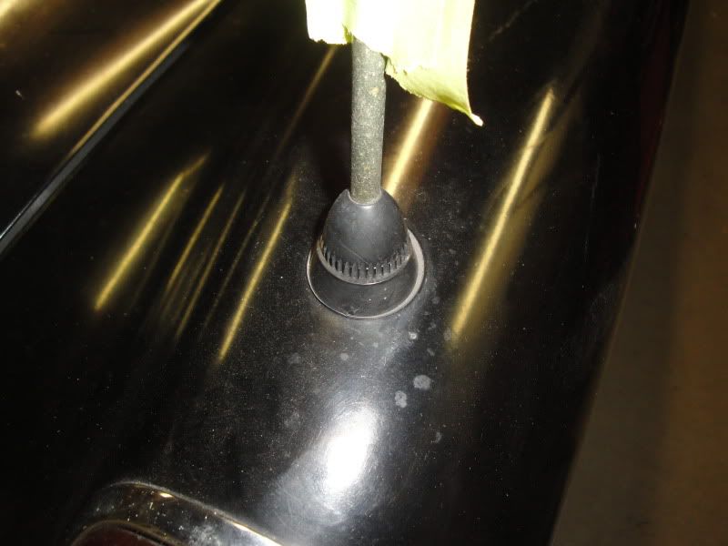

    I recently picked up a 1960 that came from the estate of the original owner. Thanks to Santa, today I received the TIMJG and have been reading through it.
    I have the original order sheet that shows the car was ordered with the radio option, but the antenna is mounted on the right rear quarter, not the left rear as the TIMJG states. The AIM (thanks to Santa again!) also shows it on the right rear. I looked through the original operations manual that came with the car and it has a picture of the antenna and it is shown on the left quarter.
    I did a quick search of the archives and found reference to a car that was at BJ which had a hole for the antenna on the right.
    Thoughts?

        In the owners manual on page 13 there is a picture of the antenna and it shows it on the right rear and the text says "Antenna is located just ahead of the tail light on the right rear fender".
        Could the car have been ordered with the radio and the dealer installed the antenna?
        Tom

            Hi Tom I think you can take it to the bank, the antenna in on the rear drivers side fender PERIOD, never seen any 56-62 corvette with radio any place else in my life. The vin plate could be on the door frame or on the column and the engine pad could have the vin stamped on the pad or not this stuff changed in 1960 but not the radio antenna. Phil 8063

                '60 AIM clearly shows the installation on the driver's rear fender, along with the routing of the antenna cable along the drivers side upper area then down unfer the sill on the driver's side. AIM sheet FOA 102, sheet #1. Also shows the static collectors in the front wheel hubs on the same page.

                  One more thing, check the inside of the rear drivers side fender for any signs that there was once an antenna installed. Look and feel for irregularities in the fiberglass.

                    Virgin fiberglass on the left side.

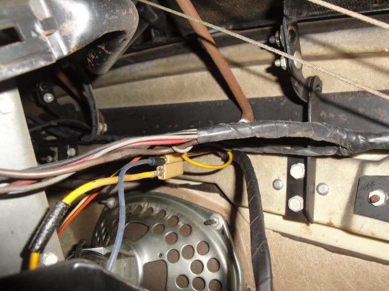

                    After looking through this today, here is what I "think" happened:
                    1. Order copy shows radio as an option
                    2. Pictures show radio is NOT an Wonderbar
                    3. Connection to radio does not have the plastic connector that plugs into the harness.
                    Could the radio have been dealer installed? I would be convinced that the owner installed the radio if it were not for the "radio" line item on the order sheet.
                    Tom

                        That sheet is the dealership writeup sheet I believe, used for recording the agreement with the buyer, as opposed to the order from the dealership to have the car built. Note the dates of 6/4 with delivery 6/5, only could happen with a car in stock. Also the non-Delco radio (let alone wonderbar) is a sure clue to a dealer-installed radio.
