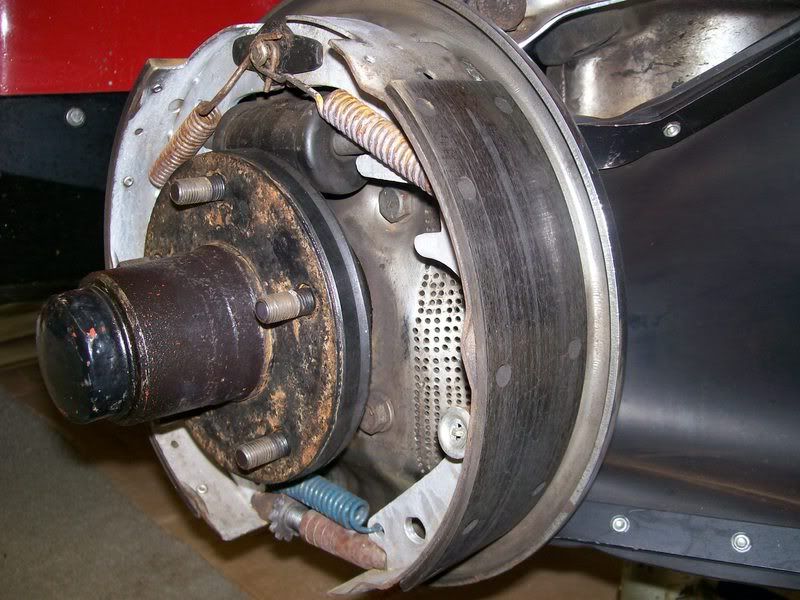

            Somewhere back in that time frame (mid-late 50s), if I remember correctly, there were also some 12in Chrysler finned alum drums used on some prototype/experimental efforts.
            For several years I've worked on getting a good functional set of big drums on the 56. I'm very pleased with what I've finally ended up with.
            This is what I started with (from the rear of mid-70s GM A-body wagons such as Malibu, Cutlass, etc).
            And this is the finished version after modification and turning in a brake lathe.
            And these are late 50s-early 60s Olds 2 1/2in FRONT shoes.
            Which I just VERY recently upgraded to self adjusting (this shows the rear).

                        Good Stuff . I like your '56 a lot.
