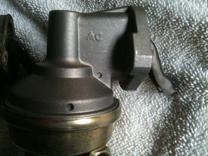

    That appears to be a 1989 box and likely a 1989 fuel pump. Nice useable NOS pump but likely has some differences in the casting, stampings and external detail from a 1972 pump.
    Hit the nail on the head! Minor casting, stampings and external detail differences!
    Does this pump have the "AC" logo on the sides of the casting?
    Yes, see side by side comparison pictures

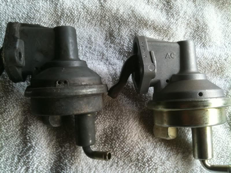

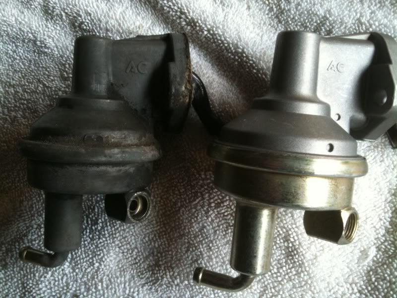

    Side by side right (original/NOS)

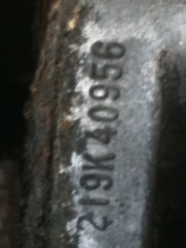

    Side by side left Notice stamping numbers on lower flange -original vs. upper flange -NOS

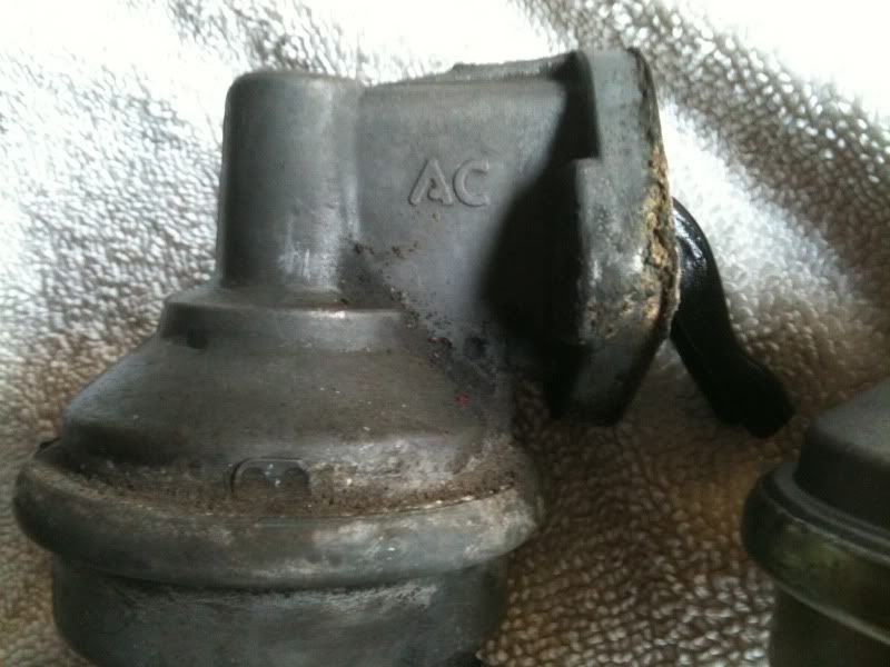

    Right side original
    Right side NOS
    Stamping numbers original
    Stamping numbers NOS

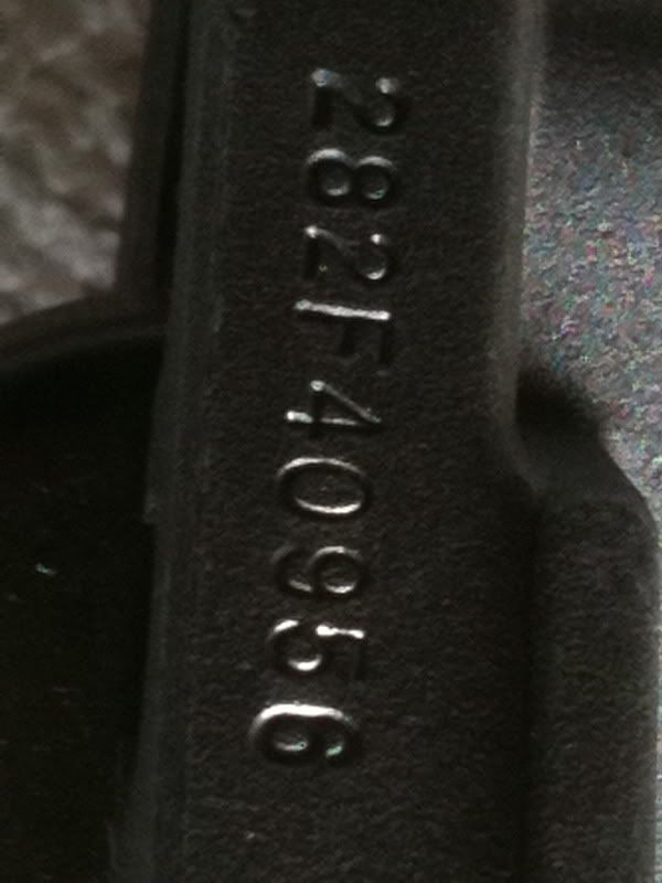

      Originally posted by Joe Ciaravino (32899)
      Clock on inside top flap of box: 10/89 = Oct 1989
      Top of Box Code: 0002J9 = 2nd week, October, 1989
      Flange Code: 282F = 282nd day (non leap year) = October 9th
      Therefore, the character "F" would represent "October" in 1989.
      Still have some questions as far as the code, compared to my original (build date of 5/10/72) vs. the NOS and the example above?
      One of the more visible differences is the angle of the fuel inlet fitting. We detail that difference in the TIM&JG.
      It does appear that the fittings are angled the same on both.

        Both of yours are 40956.
        Now compare a 40956 to a pump stamped 40709 -- THAT is where you will find the inlet angle difference. Original 1970 and I think some 1971 LT1 pumps are stamped 40709.
