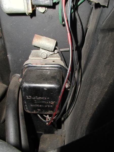

    My 64 is a November 63 built unit with radio and auto but not a/c. I replaced the radiator support and need to mount the horn relay and regulator. Were they mounted on the right backside of the rad support with the relay above the regulator? My AIM only shows the reg. mounted on the right fender and my inner fender has 3 distinct holes but I know it is not an a/c car. I see by the judging manual that all non a/c 64 built were on the right backside of the rad support. Any help appreciated.

    This is the mounting in my unrestored early '64 (built early Sept. 1963) - also with Radio, PG and no A/C.
    Todd

      Thank you. A picture is worth a lot of words.
