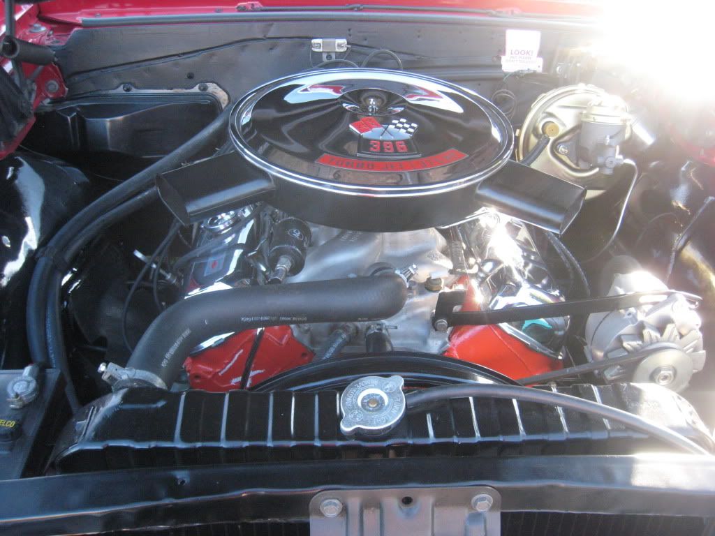

          I agree with others here that only L89 in '67 had chrome valve covers.I am not an expert by any means on the Z16 Chevelle but here is one that I took a few pictures that was getting judged at this years Hershey AACA event.It has chrome valve covers on it

            The Z16 had chrome covers as most have suggested.
