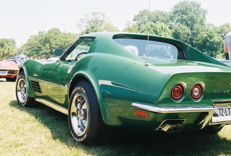

              • Roy V.
                • April 8, 2008
                • 309
                Re: 215 70R 15 vs 225 70R 15 (photos)
                these are 225's, is there really that much of a difference?
                Regards
                Roy
                1972 LT-1 Elkhart Green Coupe
                • Greg F.
                  • February 21, 2007
                  • 253
                  Regards
                  Roy
                  Thanks Roy! Are yours 60's or 70's?? That's what I'm trying to figure out....is there that much difference from the 215's to 225's?? I hope Bill can provide a picture of his 215's from the rear quarter looking down the side towards the front. That may give me an indication of the difference. Thanks again...awesome car!
                  • Roy V.
                    • April 8, 2008
                    • 309
                    Gregg, Mine are 225 70 R15's and my spare fits very easily in the spare tire carrier
                    Regards
                    Roy
