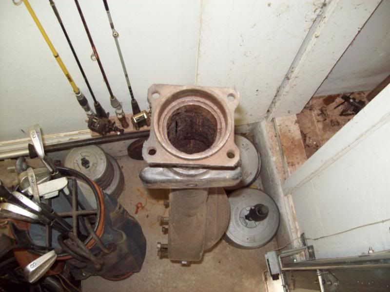

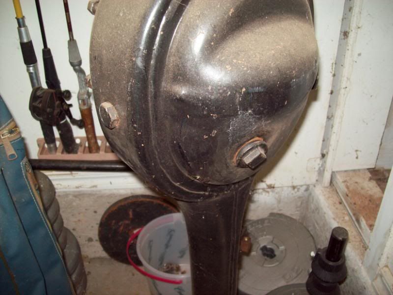

        Here's the end of my spare 57 pass car housing showing the position of the mounting holes for the brake backing plate. And another picture showing the drain plug that is on 57-61 housings (both Vettes and pass cars).

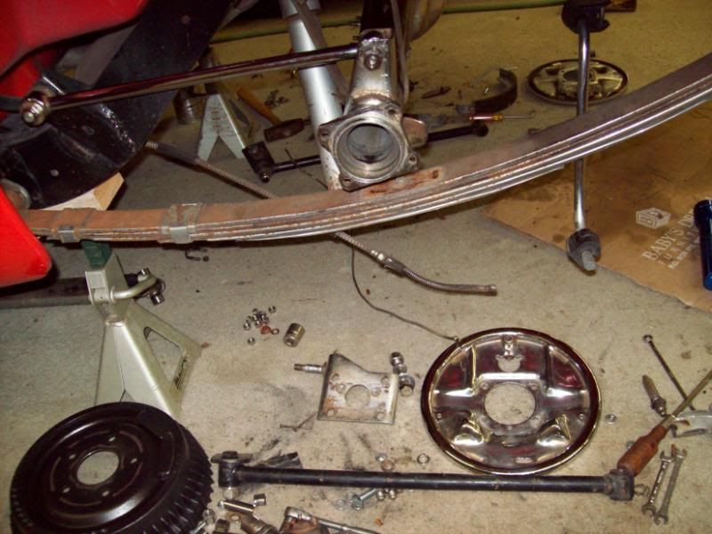

        Here's the end of a 56-62 Vette axle housing. It's quite easy to see the difference in the position of those 4 holes (this is a 60 housing in my 56).
