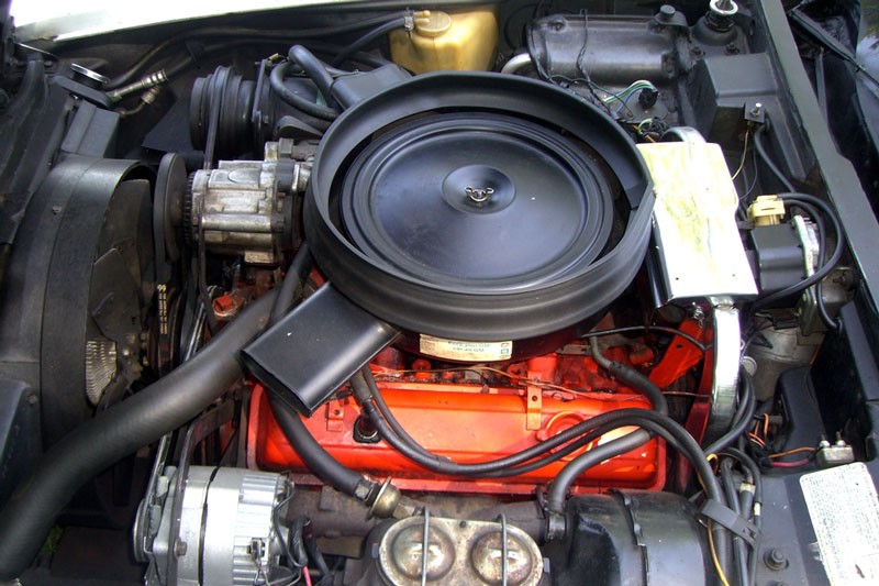

    Joe-----
    The valve covers would look very similar to the valve covers in the attached photo. I don't think there were any clips for spark plug wires. However, there were small clips on the top of the left side valve cover. You may barely be able to make out one of these on the right side valve cover in the photo. I think the 1973 configuration had 2 of these on the left side valve cover. I'm not 100% sure about the number and location of the clips, though.

        Joe, I think the only difference from your pic. maybe the drivers side valve cover may have the rubber plug oil fill cap instead of the twist on style.

            As Joe said, the two brackets on the drivers side cover do not hold spark plug wires. They simply hold the small beige wire going to the carb anti-diesel solenoid. The oil filler cap is a twist on metal type.
            Here's a picture I found on the interweeb:

                  Notice the position of the brackets in the picture they are correct for a 73. Some covers have the same brackets but are closer together and not correct.
