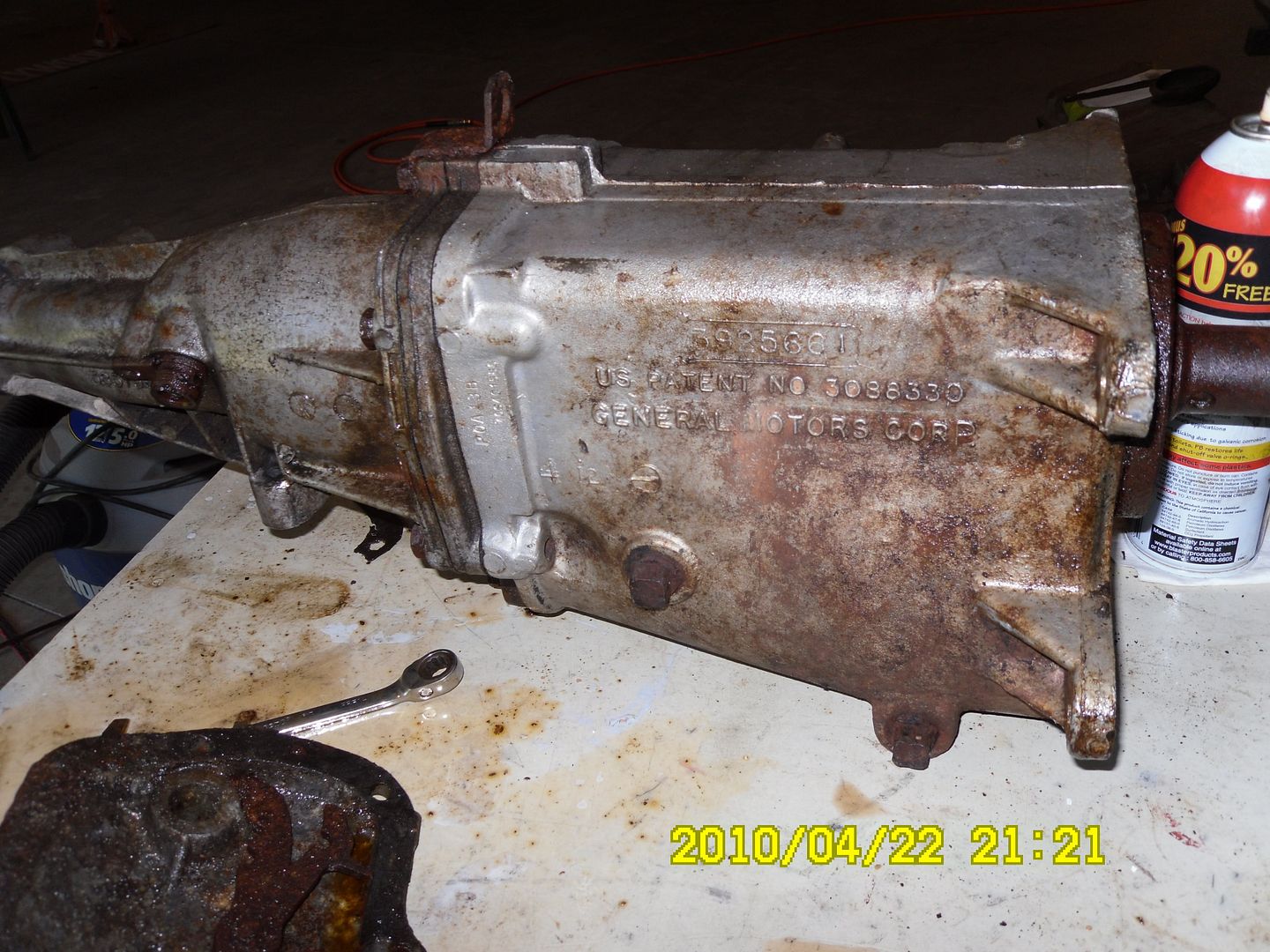

      hmmm, my 661 M21 has a drain plug. I assumed a previous owner drilled it. I will look at it closer.
        • 43248
        Re: Magnetic Muncie fill/drain plugs -- M22 only ?
        Keith------
        All '661' main cases were drilled and tapped for a drain plug.
        By the way, you are going to have a VERY interesting challenge facing you when you try to remove either the drain or fill plug from this case. If you can get them out without having to resort to drilling them out I'll be amazed.

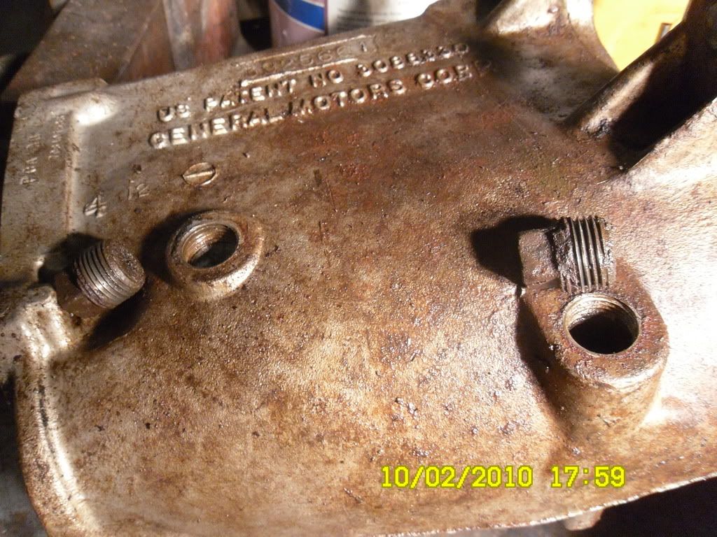

              Keith------
              Yea, I Like to have never got the speedo bullet out. He tore up the m21 and had it laying in a shed for years. At least he kept it since it is the original. Other than soaking with PB blaster any other suggestions?
                  Keith------
                  Like I say, if you can get them out any other way besides drilling them out, I'll be amazed.
                  The only other thing that MIGHT work is heat. You'd need to try heating the area of the case SURROUNDING the plugs until it gets VERY hot. Then, before it completely cools, try turning the plugs out. However, I don't think this will actually work and there is a risk to it.
                  As far as any sort of penetrating oil, hot wax, Kroil, etc., forget it! You'll just be wasting your time.
                    Keith------
                    Hey Joe, are you amazed??
                    No heat. PB blaster and time. Lots of both.
                      Keith------
                      Yes, I am amazed! I have never had any luck getting these out that easily (even if it wasn't really that easily).
                        Actually the plugs were the easy part. Getting the gears out was tough since the tranny was siezed up. Nothing would turn or slide off the shaft.
                        I will admit,I have been soaking this thing with PB blaster for months.
