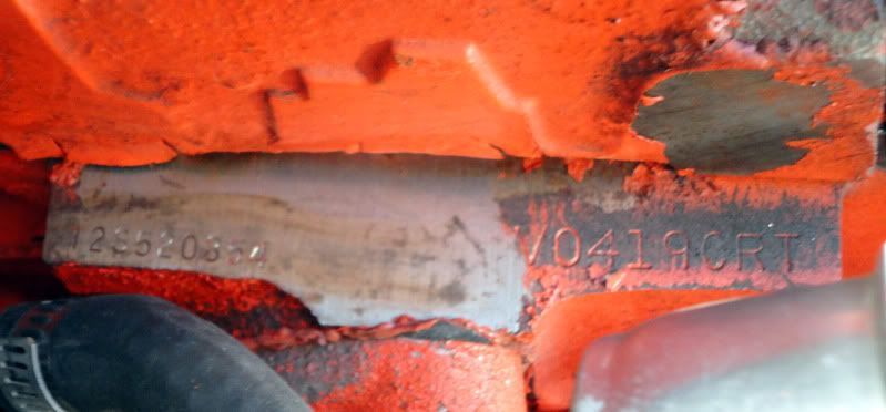

    hi all,
    I've recently come across a 1972 LT-1 T-Top (build date May 9) with an engine stamp pad suffix CRT.
    In the 70-72 technical/judging manual(4th ed.) on page 55, it is written quote "Chevrolet servie records list CRT, CPH and CPJ codes, but Flint and Tonawanda report none were produced. Their existence is unverified."
    Any ideas? Is this a special engine?

    Wolf,
    This info does not answer your question but my LT-1 has a build date of May 10, 1972 and has a VO327CKY stamp. You might be onto something neat!

      Re: 1972 LT-1 Engine Stamp Pad
      vin 20854 was built around May 9, 1972 so your April 19 assembly date fits the mold. And yes, CRT is a valid LT-1 code, but with A.I.R Smog pump. The CKY was the same engine, but no smog A.I.R system. I will bet your car was sold new in California because of the smog pump system.

                            Originally posted by Wolf Schuffner (50624)
                            hi all,
                            Wolf,
                            I've commented a few times on the CRT code (some of this should be in the archives). It would be interesting to see if your car came from CA. I believe mine did. I've seen no conclusive information on the CRT code with the research (minimal) I've done or the correspondence with Terry M. and Sal C. Let us know if you find anything out.
                            Billy
                              • 15632
                              There is a wide range between the VINs on those two cars. That is the most interesting feature to me. If there are two, there are lots more.
                              Something put on at Flint engine is different between the CRT and the CKY. The real challenge for all of us will be to figure out what that is. Flint didn't assign a different suffix code without some difference in the engine assemblies they shipped. You guys who own CRT engines might want to take the effort to find out where you car was originally delivered -- that might provide a clue to the why, but we still need to identify what drove the different suffix code.
