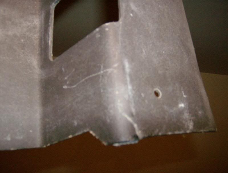

                Have had a set of originals for some time now. No vinyl covering, brownish molded fiberous material. Part number might suggest service piece. Had this discussion years ago and I believe Reba weighed in on it as to the vinyl- non vinyl thing

                    Here are the photos I promised to attach in an earlier post. Like those that Dennis posted, the ones I have are molded, rigid in construction with a grained A surface and a fiberous, unfinished B surface. I have seen these panels on numerous '70 and '71 convertibles. I just don't run into enough '72 convertibles to say more.
                    Does anyone have a known original 1972 convertible with these? If so, are they painted:
                    • At all?
                    • A surface only?
                    • Overspray around the perimeter only on the B surface?
                    • Entire B surface?
                    Thanks to all for the help!

                        I've not seen one with the back side painted, but then as Terry says I've not yet seen them all.

                          I have some panels from a 72 conv. saddle int. with overspray on the back side.
                            • 11643
                            Re: Early C3 Interior 1/4 Trim - Finish?
                            Overspray is different than "intentionally painted."
                            I don't recall ever seeing one "intentionally painted" on the back.
