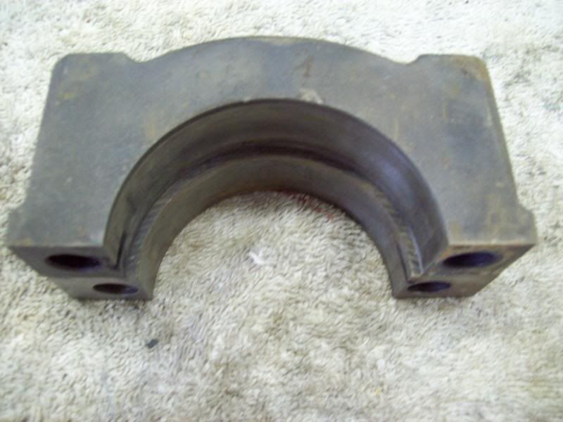

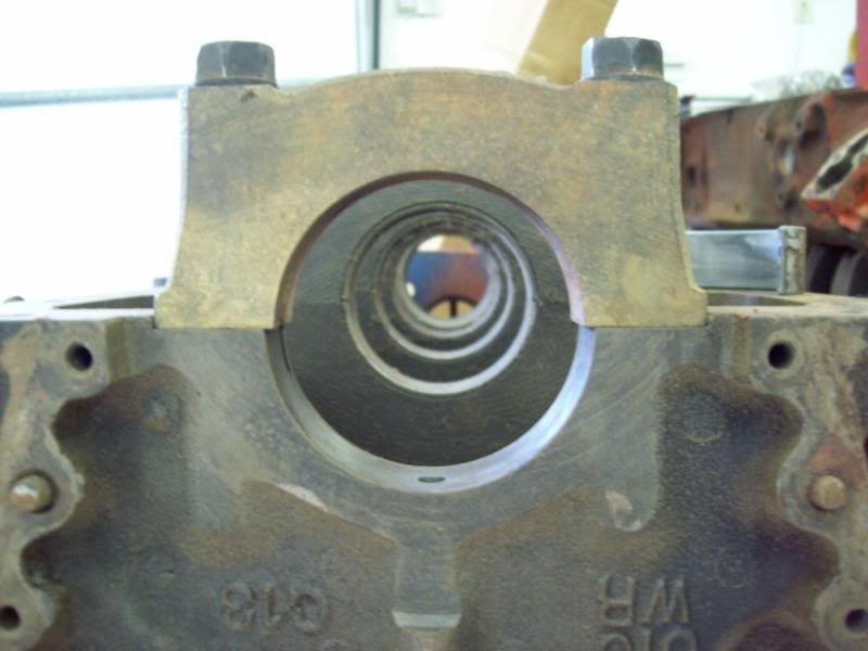

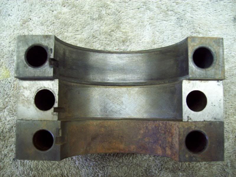

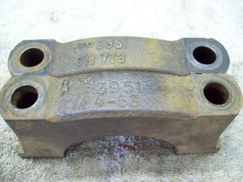

                    OK, for those who are interested, here are the differences (main journal bores) between a small journal, large journal and SB400.
                    The first picture is a small journal (327) main bearing cap bolted on a large journal (350) block which shows that the bolt centers are the same.
                    The next 3 pictures are comparrisons of small journal (327) and large journal (350) main caps. As can be seen the overall height of both caps IS THE SAME! This means that the 350 caps are thinner at the bottom of the cap. Also, notice they share the SAME number on the caps---3951!
                    This picture is a comparrison of a 350 and SB400 cap. As can be seen, there is a noticeable difference in the bolt centers. I placed the bolt holes of one side of the caps even with each other so that the difference in bolt centers is quite obvious.
                    This picture is a comparrison of the small journal (327-lower), large journal (350-center) and SB400 caps.
                    Notice PARTICULARLY the difference in the location of the notch for the bearing caps as well as the notches in the block for the bearing tangs.

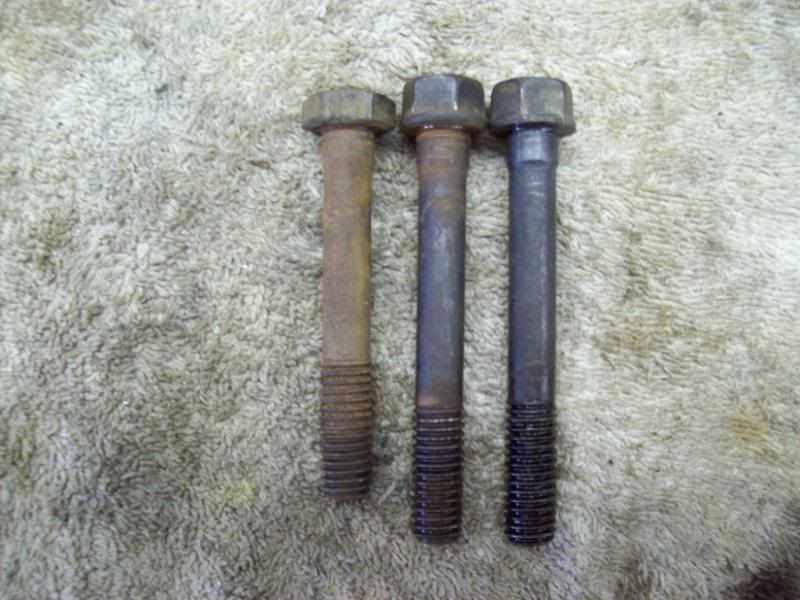

                    This last picture is the main bolts. The short bolt is for small journal blocks and has an 11/16in head. The long bolts are for BOTH large journal blocks and SB400 blocks and have 5/8in heads. Even though as shown above, the small and large journal caps are the same height, the difference is the placement of the threads in the blocks. Small journal blocks have the threads beginning at the edge of the cap register (that's the recessed area in the block where the cap fits). Large journal blocks have a pilot hole that is about 1/2in deep BEFORE the threads begin.

                      your picture showing the bearing insert tang notches is one reason to turn the crank mains rather than bore the block as putting the notches back in the block and cap would be a problem for most shops. later 350 4 bolt caps were made from nodular iron instead of plain cast iron for extra strength. the counter bore was used to prevent the block crank bore from being distorted when torquing up the mains as there was less material between the block crank bore and the threads in the 350 due to the larger bore diameter

                        Good information. As far as the main bolt spacing issue, I must have been confusing the 400 block with the 283/327/350. I knew that one was different but I thought it was between the 327 and the 350.

                            Thanks for the pictures and excellent information. In the last picture of the three main bearing cap bolts, what is the length of the 327 and 350 bolts?I have CE block ( small journal 327 3959512 ) that I would like to stroke out to a 383.The main bearing cap bolts are 5/8 and the length is 3 5/16. Are they 350 bolts are 327 bolts?
                            Thanks again Tom

                              I'll check and let you know. BUT, since you say they have a 5/8 hex head, I'm 95% sure they're the longer bolts for large journal blocks. All the small journal blocks (as I remember) had bolts with the 11/16 hex head.
