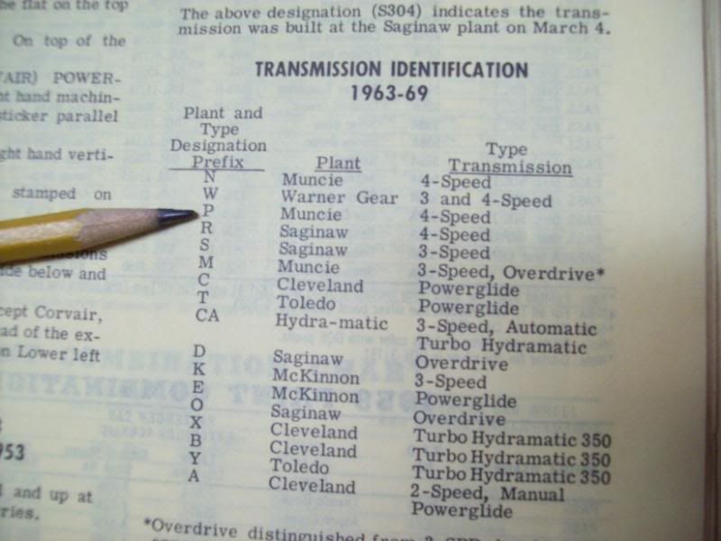

                          I think someone misinformed you. The first "P" in the transmission assembly code represents the transmission assembly plant and "P"= Muncie, Indiana, the "birthplace" of all 1963-74 Muncie 4 speed transmissions.
                          There is absolutely no difference between Muncies destined for passenger cars and Corvettes. In fact, in most cases, they even had the exact same GM part number for the assemblies.

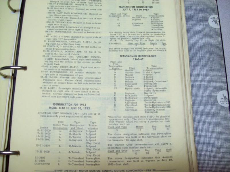

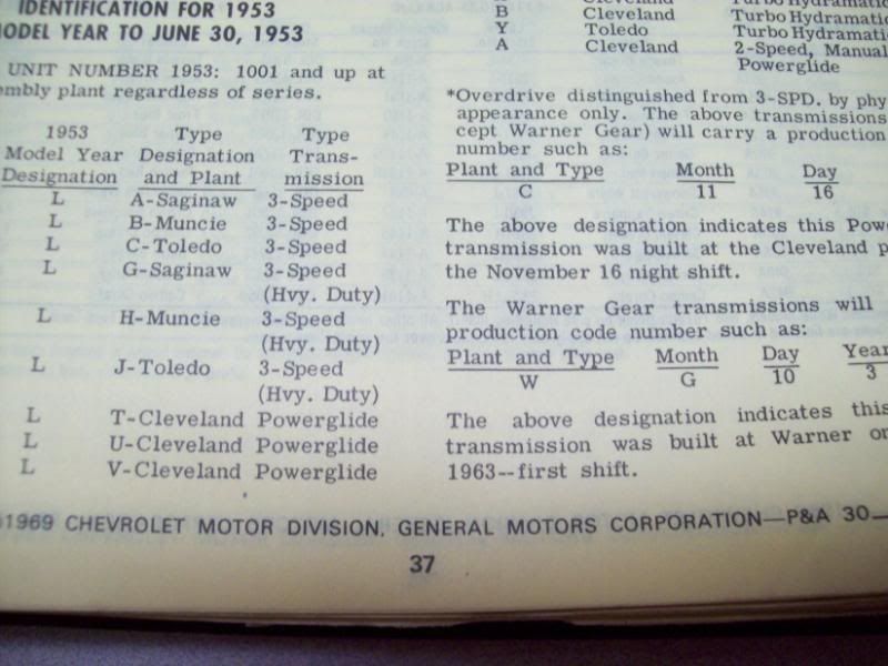

                            Joe,
                            In an early Chevrolet Parts and Accessory book I have on the shelf, on one of the front pages, it lists the codes for all the transmissions, such as the 3sp, PG, TG, 4sp, etc, etc. EACH tranny is given a code. The code given for the Muncie 4sp is P. The code for the truck 4sp is N.
                            P for Passenger Muncie (as it would appear) would include full size cars (Chev, Pont, Olds, Buick), ChevyII, Chevelle, AND CORVETTE (the Corvette is, IN FACT, a passenger car----------------as opposed to a truck). Thus, as I read the way the tranny codes are given in my Parts and Accessory book, the P that is given next to the word Muncie 4sp is the designator for for the alum case Muncie 4sp transmission for use in passenger cars-----------TO INCLUDE THE CORVETTE.
                            I'm too damn old and tired to let this get into a fight, especially with the NCRS group. I fought for years just trying to get the gear ratio disc for 3.36 and 3.55 ratios (for 62-earlier cars) changed, and finally, NCRS decided I was right (after 30yrs of banging my head against a brick wall on this issue), and it is NOW changed!!! The vendors WILL NOT change their illustration of the gear ratio discs in their catalogs until some OFFICIAL organization such as NCRS provides them with authorative documentation that they have the 3.36 and 3.55 discs reversed in their catalogs. So, I just finally gave up on that one. And I guess I'll give up on the P in Chevrolet's Parts and Accessory book beside the Muncie, Passenger being their code for the Muncie 4sp.

                              It is correct that the P coded transmissions (such as the Muncie for pass cars) were built at the Muncie plant. Put the Muncie 4sp transmission for cars had a P code, whereas the Muncie 4sp transmission with an N code was a truck transmission.
                              The Borg-Warner 4sp got a W for Warner gear, which also designated the T-10 as well as the B-W 3sp. You see the W on the T-10 cases----------------which were only used in passenger cars, which includes Corvettes.
